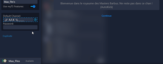

There it is the channel that I want to auto join. And it doesn’t work … In other TS server without welcome message when i set a channel here it works …
So, as in my example, it has slashes in its name. It will not work in TS5, at least for now.
You might want to contact server administration in order to change this channel’s name.
Problem here is that the client trys to connect into a sub channel first when using slashes.
We know about that issue already and have it on our to do list.
