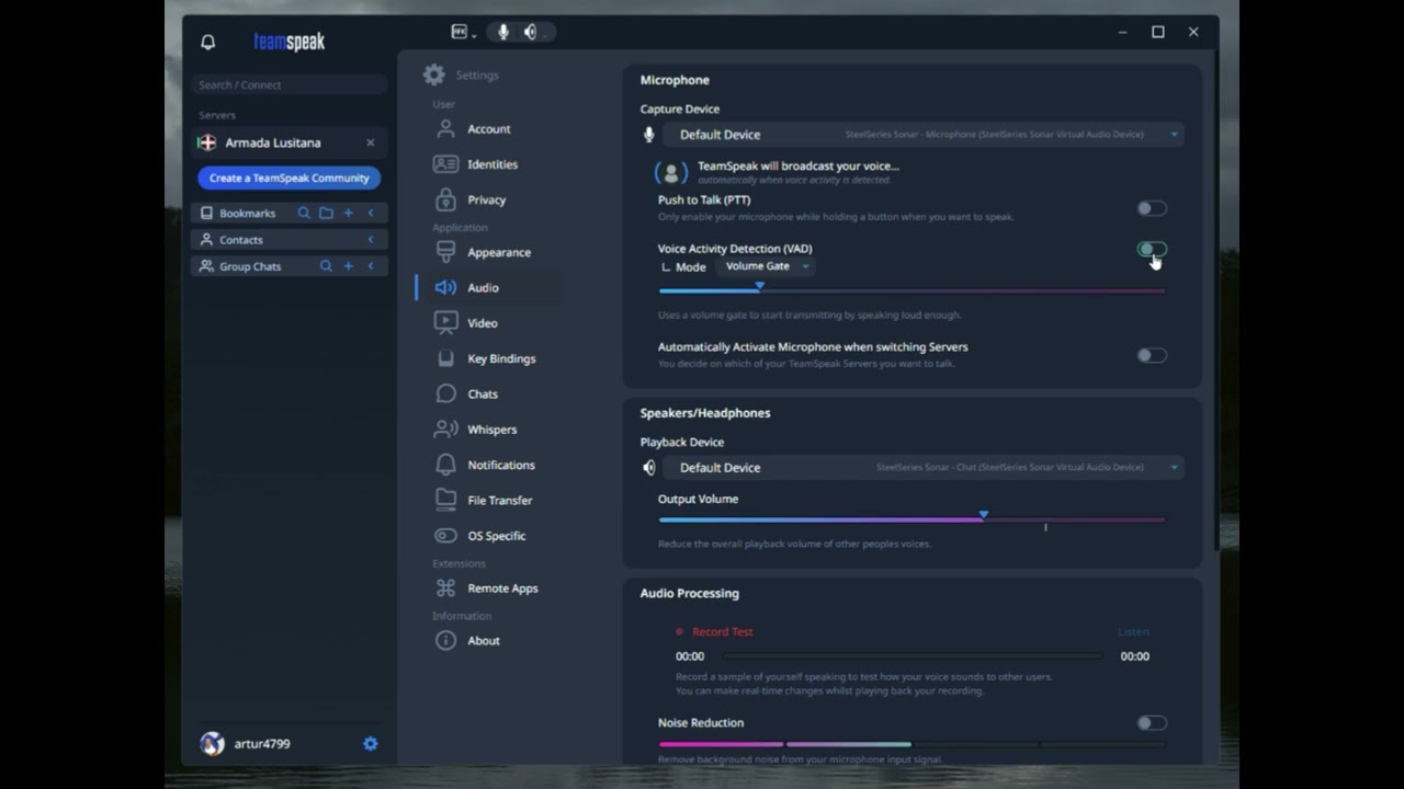

Issue 1
Whenever I launch TeamSpeak, the microphone is immediately detected as constantly active, even when there is no speech.
microphone
The only way I have found to make Automatic VAD behave correctly is to perform the following steps every time I start TeamSpeak:
  1. Open Audio settings.
  2. Change VAD from Automatic to either Volume Gate or Hybrid.
  3. Disable VAD.
  4. Enable VAD again.
  5. Change VAD back to Automatic.
After doing this, Automatic VAD behaves normally for the rest of the session.
Issue 2
I cannot permanently select any VAD mode other than Automatic. If I select either Volume Gate or Hybrid , the setting appears to change, but as soon as I leave the Audio configuration page (or return to it later), it is reset back to Automatic.
Because of this, the only usable mode is Automatic. Here is a video demo:
I didn’t find a workaround for this issue.
I previously used Volume Gate without any issues because I use SteelSeries Sonar for capture/playback processing and device management. I do not know what changed, but this behavior started occurring recently.
