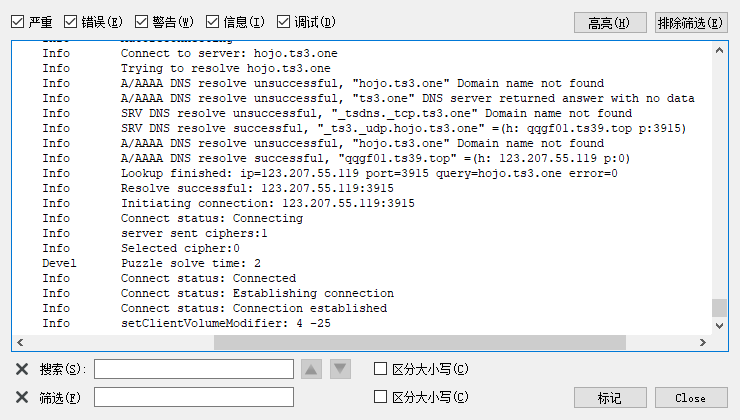

My TeamSpeak 3 frequently disconnects, but others on the same server do not encounter this issue. The same problem occurs on other servers, and automatic reconnection often takes several minutes. I have reviewed the client logs as shown in the image and would like to inquire about how to resolve this issue.
could you help me with this? @TS.ChrisR
