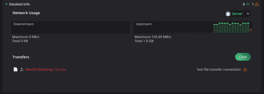

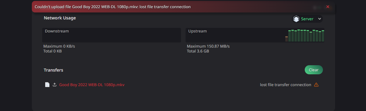

Need help ts6 file transfer lost connection
Using the teamspeak server beta 7 with the most up to date client (3.4) and everyone on my server gets this error uploading anything bigger than a couple MBs
“lost file transfer connection”
30033 is forwarded and 9987 so im unsure why we get this error

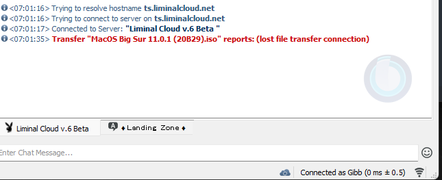

The issue is persistent on both beta and ts 3
How big is the file size? And is the issue then consistent with different files over this “limit”?

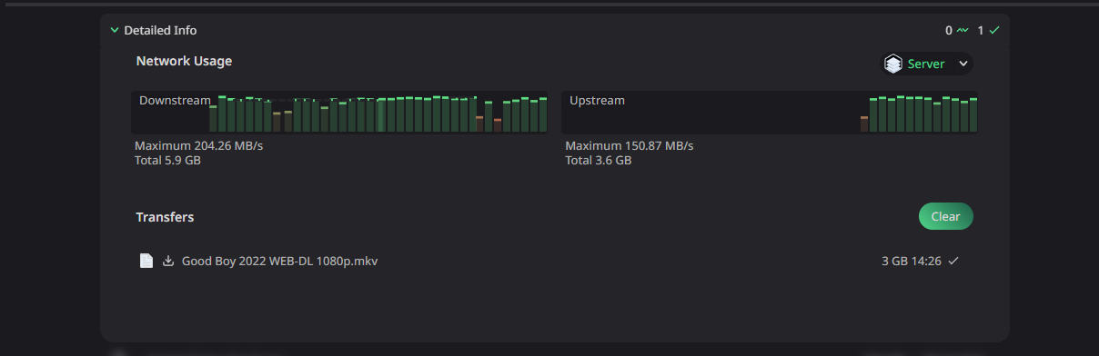

This file was 1.9 GB. smaller sizes upload and download fine, i don’t know if it is the size per say that is the issue but maybe more the amount of time on the transfer, ive noticed a 200 MB file i can download fine cause im hosting and its a near instant download where as my buddy that lives a couple states over with an average ping of 35ms can’t download that same file because it takes longer for him and after about 30 seconds of downloading it drops to 0 bits a seconds download rate then fails with that error “lost file transfer connection”
it almost acts like every couple seconds the socket resets and drops all file transfers but i cannot provide evidence for that specifically as i havent tested more than one transfer at the same time with multiple users but i can later today and see if it kills them all at once
I went through the logs and couldn’t find any Filetransfer specific errors. Instead, there are two different issues showing up:
error during deleteFile for files\virtualserver_1\channel_6/MacOS Monterey 12.4.iso: 桔⁥牰捯獥⁳慣湮瑯愠捣獥⁳桴⁥楦敬戠捥畡敳椠⁴獩戠楥杮甠敳⁤祢愠潮桴牥瀠潲散獳.txt
The error message somehow broke due to an encoding issue, but it basically says that the file is locked by another process.
An operation was attempted on something that is not a socket
This is a Windows socket error and it looks like the server tried to send data after the connection was already gone.
I wasn’t able to reproduce this issue. Given the pattern - works locally, but fails remotely after a few seconds — this is more likely a network issue than a TeamSpeak Filetransfer error.
Could you provide client logs from when the issue occurs?
Does it happen with multiple different clients, or just this one?

This is my client log on trace mode, i opened teamspeak, joined my server, tried to upload the same file that is 1.9 GB and i instantly get a lost connection to transfer
as for if this is on more than one client, yes doesnt matter if its the beta or ts 3, also affects people off my own network aswell
Thanks for the additional details.
At the moment, we are unfortunately unable to reproduce this behavior on our side. There are several factors that could influence this, including file I/O performance and network I/O or timeout handling on both the client and server side. These can vary significantly depending on the environment and may contribute to the issue you are seeing.
Since we can’t reproduce the problem, it is difficult for us to verify whether a specific changes fully fixes the issue. We are still investigating this internally and keeping it on our radar, but this will not be part of the next beta server release.
Some more additional info,
Update beta 8 its still accuring, though ive noticed i get to like %60 done with the file before same issue as before.
I use Ubiquiti equipment, the server PC i use is Windows 11 pro on intel CPU, The computer its-self is on its own vlan by itself but it has permission to talk to my internal vlan and the outside world. I have it DMZed basically.

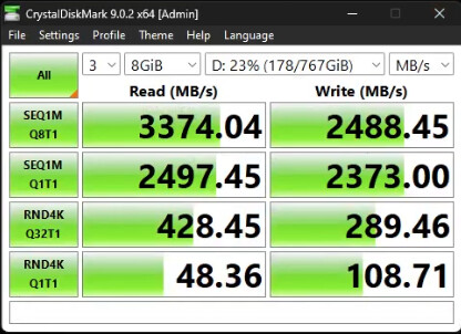

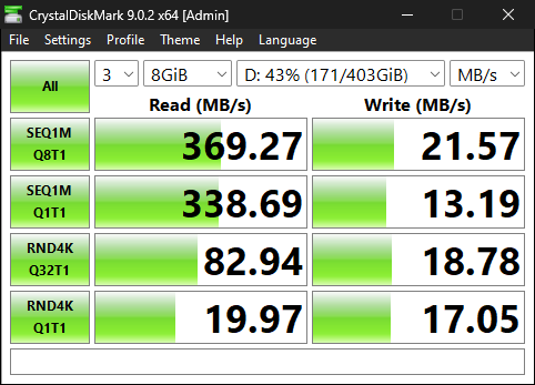

The ts Server is on a separate drive than windows, D:/ts_server is its directory. I run it as administrator and its on an admin account, The disk has more than 400 GB available to use.

I can upload the files using other software like RustDesk to upload them into the file browser internal file system and it seems as of today i can download a 3GB file so maybe downloading is fixed
quick update. not sure what has changed but one of my users downloaded a 4.3 gb file and reuploaded it without issue, but i cannot upload that same file for some reason i get the file transfer connection lost error so idk
Maybe you could handle this with setting up an S3 server on the same machine and use this as storage?
