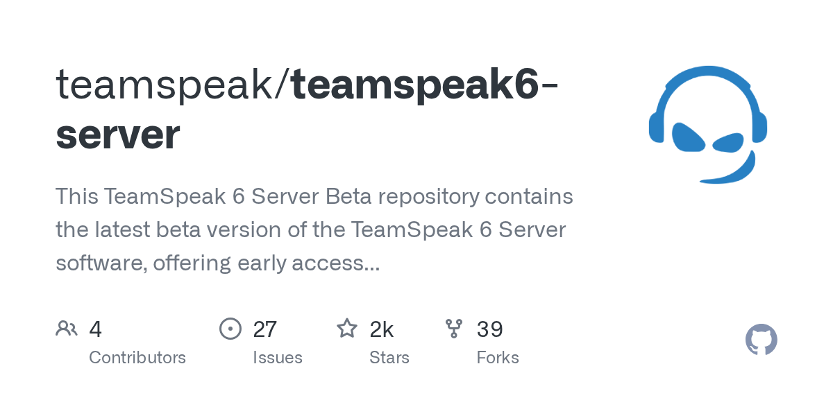

This being on a Group Chat, is there any way around this? Or the only way would it be on a Server? Also, I believe the servers are paid, correct? Is there a way to make a private, small server for only our friends?
Thank you again for your tips and info
That shouldn’t happen, thats strange.
You can rent servers/communities or you could selfhost your own server:
Thank you very much, for the quick response.
Yeah that is strange but it keeps happening, like around 1/2 minutes after the second screen starts the previous one close, I went to look for some configuration options, but i’ve found nothing about it.
Regarding the Selfhost server, it would not be paid correct? (I will begin the reading of the article you sent me now)
