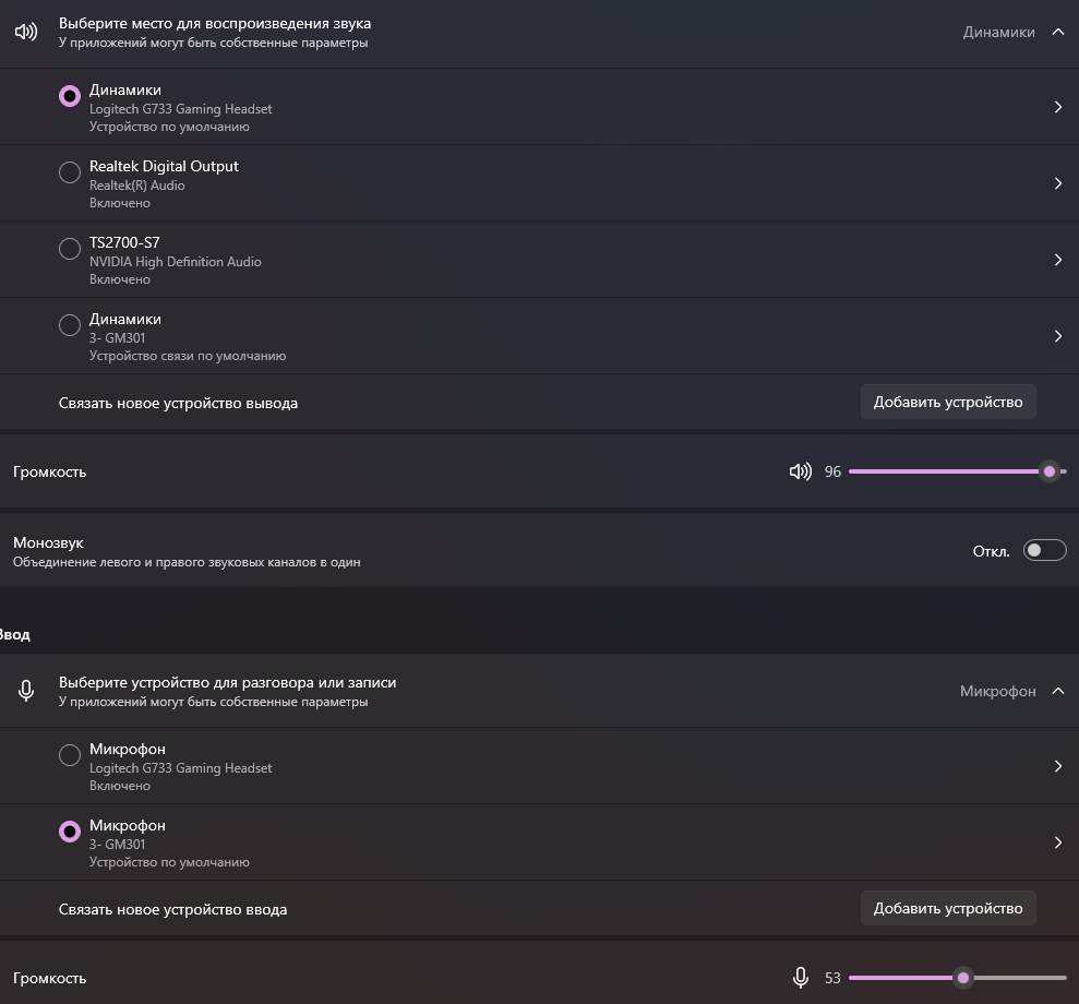

Hello, I would like to know why when I broadcast my screen to the server, the sound is transmitted, but when another user broadcasts their screen, there is no sound?
  • What OS is the other user using
  • is the checkbox to transmit sound enabled?
  • Please check in your windows settings that the correct ones is also set as a default communication device.
Windows OS
checkbox is checked
sound settings are set correctly
Are you the only one that has no sound or can others not hear it as well?
They can hear the sound on my broadcast, but when others broadcast, they have no sound, even though everything is fine according to the settings.
Can you please send a screenshot of the connection info view in the audio tab?
Other users have the same
Exactly this is your issue:
