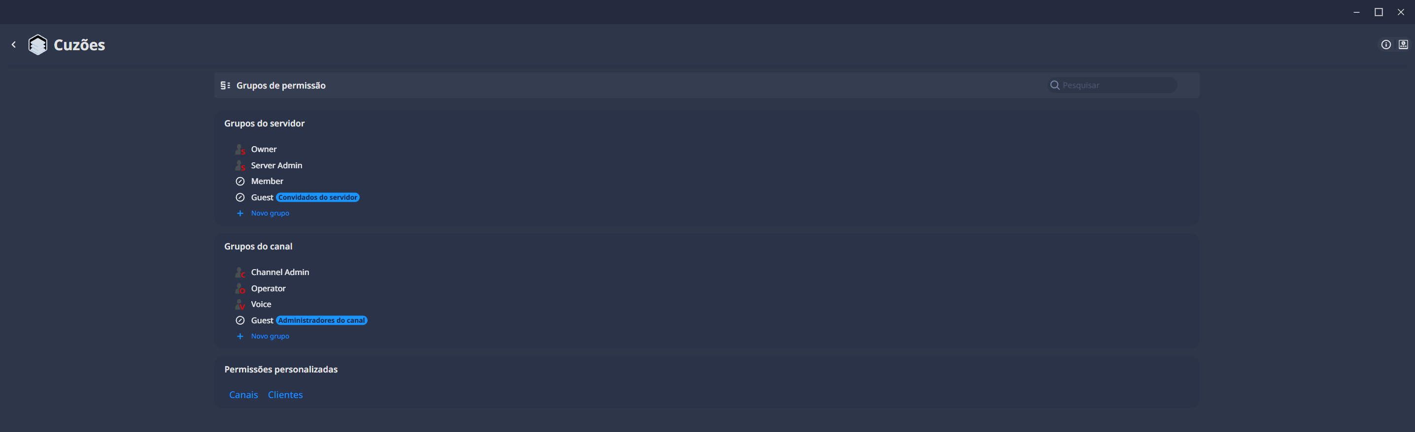

This is my first time using TeamSpeaker. I created my first server, but while tinkering with it, I accidentally set the “guest” group as channel group administrators, and now I can’t revert to “Channel Admin” due to permission issues. How can I fix this?

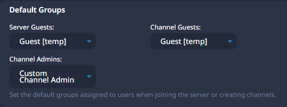

In your server settings, you can change your default server and channel groups.
Make sure to open the advanced settings.
For Channel Admins, you should select “Channel Admin.” As a note, my screenshot shows a group I created myself.
When I try to change the channel administrators and remove the guest, an error message appears
”Error setting the Flush property: Invalid Group ID”
