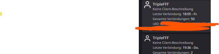

Can you check if your friend tried with a different identity?
Right-click the Server and select Client List. There you should search for a duplicated entry. Do you see any there?
I checked it. Only when he tried with TS3 I can see that he had another identity.
The fix for him was to increase his security level then it worked with the same identity.
Is there something else I can provide you?
Thank you for your reply.
This is making me even more suspicious, that he was using TS3 before and now switched to TS6? Is that possible?
If this issue comes up again we could take a look at it, however this does not seem to be a bug, rather an issue with the identity configuration on the user’s side.
