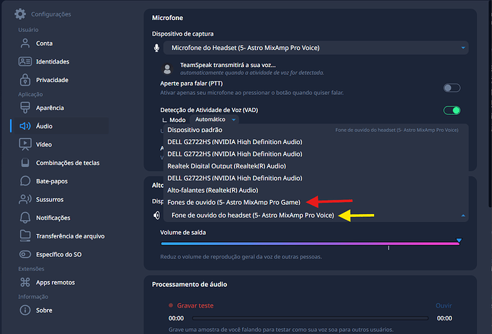

My TeamSpeak is in portuguese, i´m From Brazil. The Astro A40 have 2 channels, one for Games and Windows sounds and a second channel for voice, so with the MixAmp Knob you can select more voice than game or let both equals and a Knob for volume up and Down.
On windows sounds is Astro MixAmp Pro Game, and on TeamSpeak, Discord and other voice programs is Astro MixAmp Pro Voice.

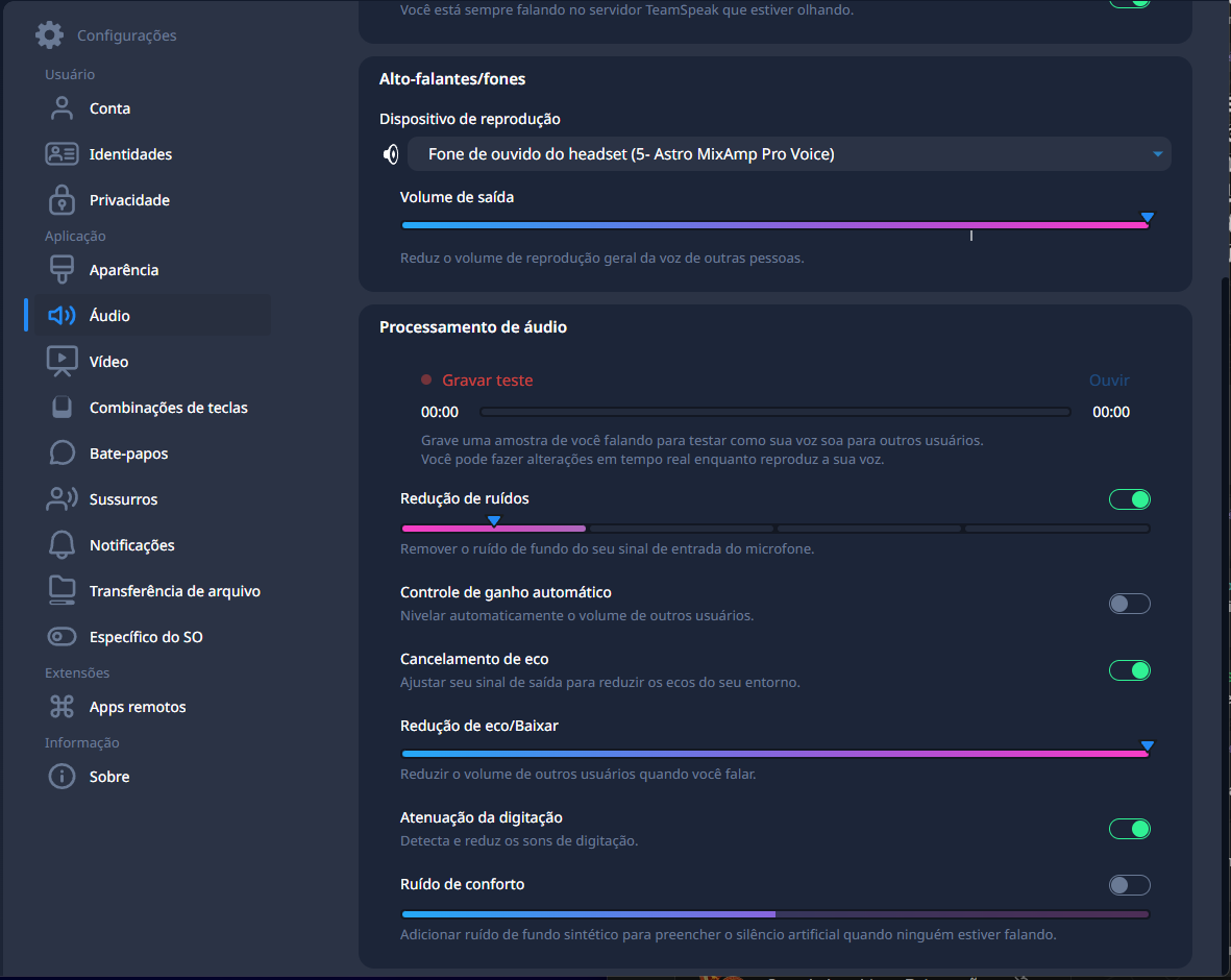

I just turned off the AGC cause some users the mic sound is lower than others, so i have to set more dB on a specific user…
replying this to show one more print of the other settings of TeamSpeak Audio Settings, cause new users just can upload one image per post.
Can you check if the output volume is louder when disabling “Cancelamento de eco”?
“Controle de ganho automático” is our automatic gain control, meaning if enabled quieter users will get a small volume boost.
The automatic gain control can be used all the time and does not need to be disabled when adjusting individual users volume.
