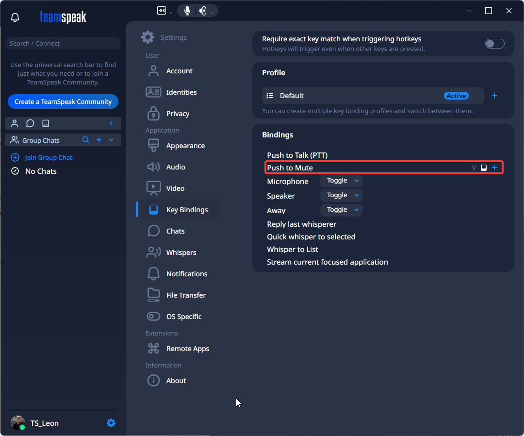

If I understood correctly, then you are able to set this up by simply setting the in game voice chat button to the same as Push To Mute.
You’re right! I initially thought it wasn’t working because there was no visual indication that my mic was muted. But after testing it, everything seems to work as intended, even though the mute icon doesn’t appear, my mic is indeed muted. Thanks a lot!
While that does work for OP needs, I still like the idea of TS6 not losing the configuration options we had in TS3, even if an advanced screen view is needed so most can keep the simpler default layout.
