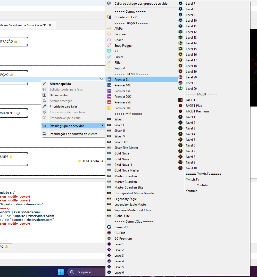

Allow the user to choose their own group and only their own group
I would like to know if it would be possible for someone in the REGISTERED group to be able to add and remove groups for themselves, but not be able to add or remove groups for other users. Currently, I’ve managed to make it so that they can add and remove groups for themselves, but also for other users.
Would it be possible to remove only this permission to add and remove groups for third parties, leaving this option only for the user in the REGISTERED group?
