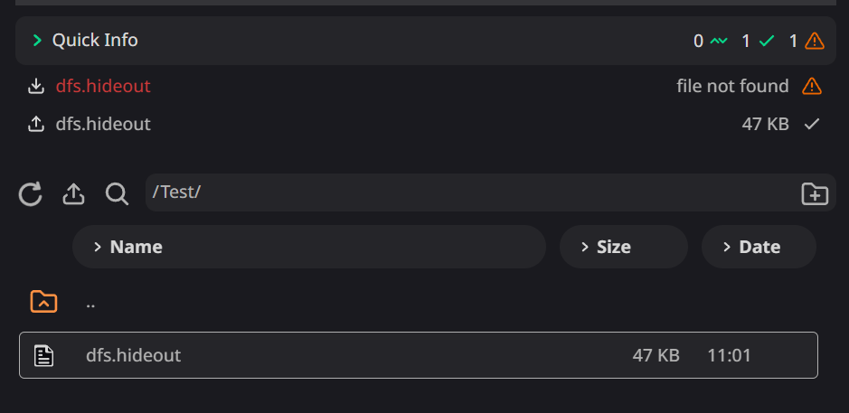

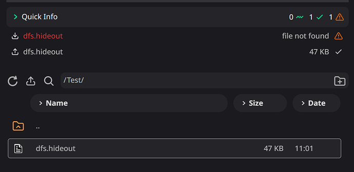

As you can see in the screenshot I uploaded dfs.hideout.
My very next click is on the bottom trying to download it.

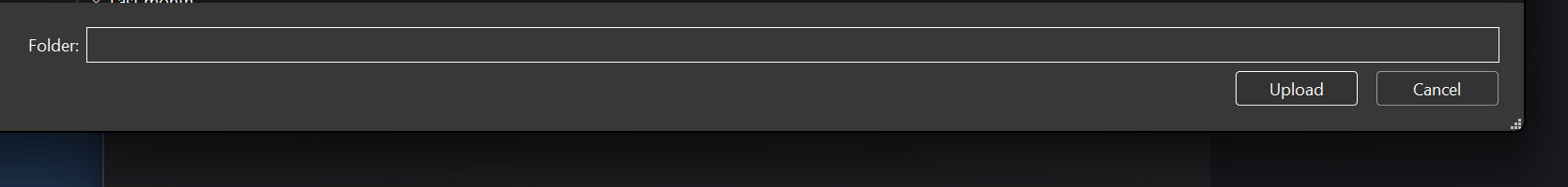

Weird thing I noticed is when I pick the location of the download it instead says “upload”, I tried this with a friend as well and he’s experiencing the same thing on my server.
After choosing a location for the download and then clicking the “bugged Upload” I get the error in image 1 → dfs.hideout file not found.
I check on my linux server and I can see the folder and the file in there and I tried giving full permissions but nothing solved the issue.
