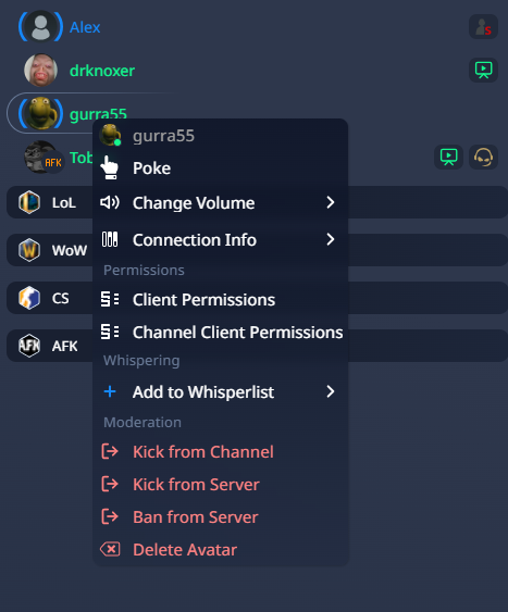

Im not able to give friends or myself any roles at all so even if i make a new one nothing changes.
I just confirmed with a new server instance that the permissions are working as intended and icons can also be set.
Assigning new groups to myself works as well.

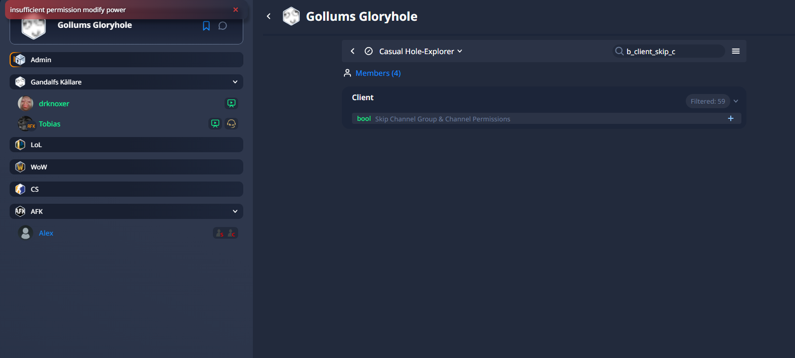

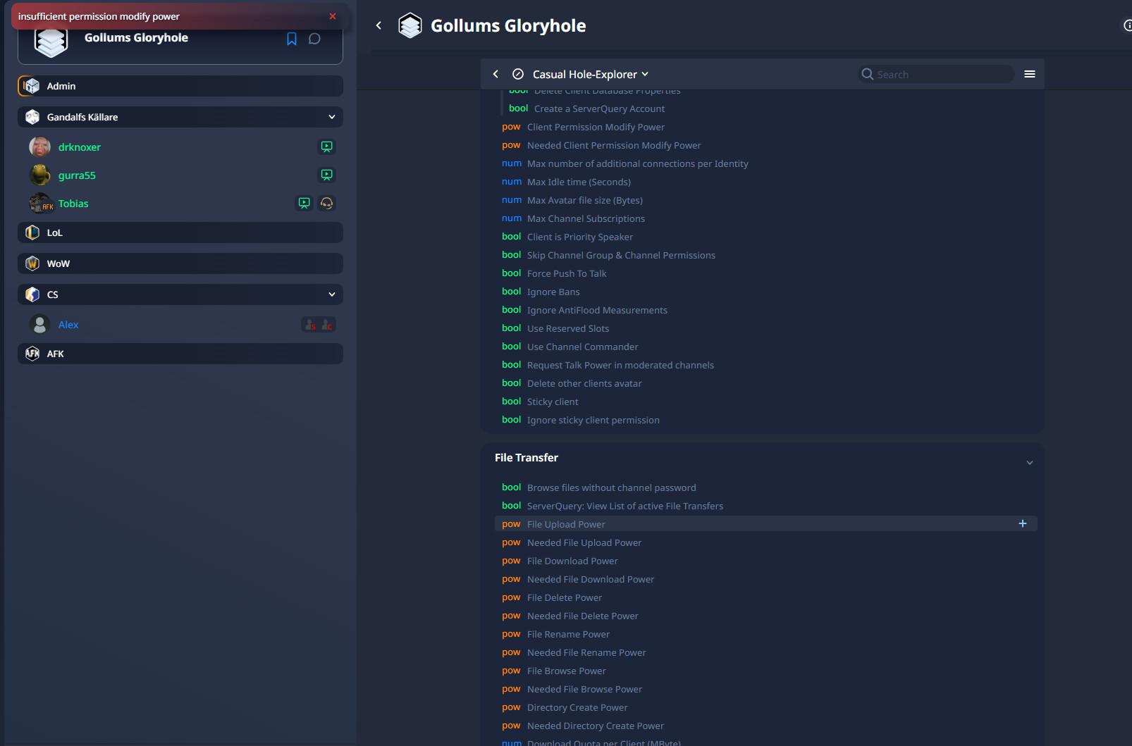

This is what happens when i try to add an icon or change permissions on a role.
Its impossible to do anything at all.
you can see that i have icons on my channels but im not able to change them now so something is not right.
Make sure your groups have b_client_skip_channelgroup_permissions otherwise you are limited by your channel group.
Not able to add it as i just get this error for anything im trying to do.

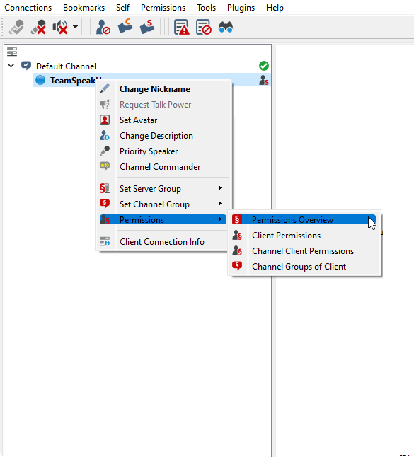

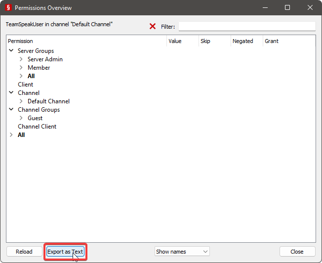

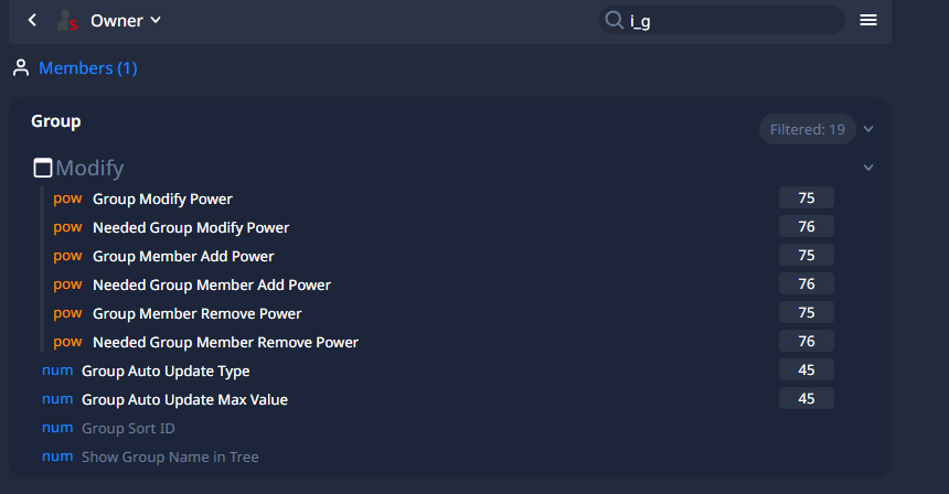

To further investigate this issue without random guessing. I’ll need a Permission overview. For that you’ll need to download the TS3 client, no login needed. But the client needs the Server Admin group.
Either upload the file to a media sharing service or as plain text here as a reply.
The only issue here is that it says that im not Server Admin or anything and i cant give it to myself either.
Is it something that im missing?
When i join on TS6 im Owner but cant give a role to the one i joined with on TS3
Sorry forgot about this. In this case you’ll need to login with out myTS account and use your bookmark to connect to it.
Thanks, that worked :smiley:

i_ft_file_rename_power 75 0 0 75
i_ft_needed_file_rename_power    75
i_ft_file_browse_power 75 0 0 75
i_ft_needed_file_browse_power    75
i_ft_directory_create_power 75 0 0 75
i_ft_needed_directory_create_power    75
i_ft_quota_mb_download_per_client -1 0 0 75
i_ft_quota_mb_upload_per_client -1 0 0 75
b_virtualserver_start_any    100
b_virtualserver_stop_any    100
Casual Hole-Explorer
b_group_is_permanent 1 0 0
i_group_needed_modify_power 1 0 0
i_group_needed_member_add_power 50 0 0
i_group_needed_member_remove_power 50 0 0
All
b_virtualserver_info_view 1 0 0 75
b_virtualserver_connectioninfo_view 1 0 0 75
b_virtualserver_channel_list 1 0 0 75
b_virtualserver_channel_search 1 0 0 75
b_virtualserver_client_list 1 0 0 75
b_virtualserver_client_search 1 0 0 75
b_virtualserver_client_dblist 1 0 0 75
b_virtualserver_client_dbsearch 1 0 0 75
b_virtualserver_client_dbinfo 1 0 0 75
b_virtualserver_permission_find 1 0 0 75
b_virtualserver_custom_search 1 0 0 75
b_virtualserver_start    100
b_virtualserver_stop    100
b_virtualserver_token_list 1 0 0 75
b_virtualserver_token_add 1 0 0 75
b_virtualserver_token_use 1 0 0 75
b_virtualserver_token_delete 1 0 0 75
b_virtualserver_apikey_add    100
b_virtualserver_apikey_manage    100
b_virtualserver_log_view 1 0 0 75
b_virtualserver_join_ignore_password 1 0 0 75
b_virtualserver_notify_register 1 0 0 75
b_virtualserver_notify_unregister 1 0 0 75
b_virtualserver_canonical_name_manage 1 0 0 75
b_virtualserver_modify_name 1 0 0 75
b_virtualserver_modify_welcomemessage 1 0 0 75
b_virtualserver_modify_reserved_slots 1 0 0 75
b_virtualserver_modify_password 1 0 0 75
b_virtualserver_modify_default_servergroup 1 0 0 75
b_virtualserver_modify_default_channelgroup 1 0 0 75
b_virtualserver_modify_default_channeladmingroup 1 0 0 75
b_virtualserver_modify_channel_forced_silence 1 0 0 75
b_virtualserver_modify_complain 1 0 0 75
b_virtualserver_modify_antiflood 1 0 0 75
b_virtualserver_modify_port    100
b_virtualserver_modify_autostart    100
b_virtualserver_modify_needed_identity_security_level 1 0 0 75
b_virtualserver_modify_priority_speaker_dimm_modificator 1 0 0 75
b_virtualserver_modify_icon_id 1 0 0 75
b_virtualserver_modify_weblist 1 0 0 75
b_virtualserver_modify_codec_encryption_mode 1 0 0 75
b_virtualserver_modify_temporary_passwords 1 0 0 75
b_virtualserver_modify_temporary_passwords_own 1 0 0 75
b_virtualserver_modify_channel_temp_delete_delay_default 1 0 0 75
b_virtualserver_modify_nickname 1 0 0 75
b_virtualserver_modify_integrations 1 0 0 75
b_virtualserver_modify_mytsid_connect 1 0 0 75
i_channel_min_depth    75
i_channel_max_depth 10 0 0 75
b_channel_group_inheritance_end    75
i_channel_permission_modify_power 75 0 0 75
i_channel_needed_permission_modify_power    75
b_channel_info_view 1 0 0 75
b_channel_create_child 1 0 0 75
b_channel_create_permanent 1 0 0 75
b_channel_create_semi_permanent 1 0 0 75
b_channel_create_temporary 1 0 0 75
b_channel_create_with_topic 1 0 0 75
b_channel_create_with_description 1 0 0 75
b_channel_create_with_password 1 0 0 75
b_channel_create_with_banner 1 0 0 75
b_channel_create_modify_with_codec_opusvoice 1 0 0 75
b_channel_create_modify_with_codec_opusmusic 1 0 0 75
i_channel_create_modify_with_codec_maxquality 10 0 0 75
i_channel_create_modify_with_codec_latency_factor_min 1 0 0 75
b_channel_create_with_maxclients 1 0 0 75
b_channel_create_with_maxfamilyclients 1 0 0 75
b_channel_create_with_sortorder 1 0 0 75
b_channel_create_with_default 1 0 0 75
b_channel_create_with_needed_talk_power 1 0 0 75
b_channel_create_modify_with_force_password    75
i_channel_create_modify_with_temp_delete_delay 86400 0 0 75
b_channel_modify_parent 1 0 0 75
b_channel_modify_make_default 1 0 0 75
b_channel_modify_make_permanent 1 0 0 75
b_channel_modify_make_semi_permanent 1 0 0 75
b_channel_modify_make_temporary 1 0 0 75
b_channel_modify_name 1 0 0 75
b_channel_modify_topic 1 0 0 75
b_channel_modify_description 1 0 0 75
b_channel_modify_password 1 0 0 75
b_channel_modify_banner 1 0 0 75
b_channel_modify_codec 1 0 0 75
b_channel_modify_codec_quality 1 0 0 75
b_channel_modify_codec_latency_factor 1 0 0 75
b_channel_modify_maxclients 1 0 0 75
b_channel_modify_maxfamilyclients 1 0 0 75
b_channel_modify_sortorder 1 0 0 75
b_channel_modify_needed_talk_power 1 0 0 75
i_channel_modify_power 75 0 0 75
i_channel_needed_modify_power    75
b_channel_modify_make_codec_encrypted 1 0 0 75
b_channel_modify_temp_delete_delay 1 0 0 75
b_channel_modify_ft_quotas 1 0 0 75
b_channel_delete_permanent 1 0 0 75
b_channel_delete_semi_permanent 1 0 0 75
b_channel_delete_temporary 1 0 0 75
b_channel_delete_flag_force 1 0 0 75
i_channel_delete_power 75 0 0 75
i_channel_needed_delete_power    75
b_channel_join_permanent 1 0 0 75
b_channel_join_semi_permanent 1 0 0 75
b_channel_join_temporary 1 0 0 75
b_channel_join_ignore_password 1 0 0 75
b_channel_join_ignore_maxclients 1 0 0 75
i_channel_join_power 75 0 0 75
i_channel_needed_join_power    75
i_channel_subscribe_power 75 0 0 75
i_channel_needed_subscribe_power    75
i_channel_description_view_power 75 0 0 75
i_channel_needed_description_view_power    75
i_icon_id 300 0 0 75
i_max_icon_filesize 8192 0 0 75
b_icon_manage 1 0 0 75
b_group_is_permanent 1 0 0 75
i_group_auto_update_type 45 0 0 75
i_group_auto_update_max_value 45 0 0
i_group_sort_id    75
i_group_show_name_in_tree    75
b_virtualserver_servergroup_list 1 0 0 75
b_virtualserver_servergroup_permission_list 1 0 0 75
b_virtualserver_servergroup_client_list 1 0 0 75
b_virtualserver_channelgroup_list 1 0 0 75
b_virtualserver_channelgroup_permission_list 1 0 0 75
b_virtualserver_channelgroup_client_list 1 0 0 75
b_virtualserver_client_permission_list 1 0 0 75
b_virtualserver_channel_permission_list 1 0 0 75
b_virtualserver_channelclient_permission_list 1 0 0 75
b_virtualserver_servergroup_create 1 0 0 75
b_virtualserver_channelgroup_create 1 0 0 75
i_group_modify_power 75 0 0 75
i_group_needed_modify_power 76 0 0 75
i_group_member_add_power 75 0 0 75
i_group_needed_member_add_power 76 0 0 75
i_group_member_remove_power 75 0 0 75
i_group_needed_member_remove_power 76 0 0 75
i_permission_modify_power 75 0 0 75
b_virtualserver_servergroup_delete 1 0 0 75
b_virtualserver_channelgroup_delete 1 0 0 75
i_client_permission_modify_power 75 0 0 75
i_client_needed_permission_modify_power 75 0 0 75
i_client_max_clones_uid 10 0 0 75
i_client_max_idletime    75
i_client_max_avatar_filesize 200000 0 0 75
i_client_max_channel_subscriptions -1 0 0 75
b_client_is_priority_speaker    75
b_client_skip_channelgroup_permissions 1 0 0 75
b_client_force_push_to_talk    75
b_client_ignore_bans 1 0 0 75
b_client_ignore_antiflood 1 0 0 75
b_client_use_reserved_slot 1 0 0 75
b_client_use_channel_commander 1 0 0 75
b_client_request_talker 1 0 0 75
b_client_avatar_delete_other 1 0 0 75
b_client_is_sticky    75
b_client_ignore_sticky 1 0 0 75
b_client_info_view 1 0 0 75
b_client_permissionoverview_view 1 0 0 75
b_client_permissionoverview_own 1 0 0 75
b_client_remoteaddress_view 1 0 0 75
i_client_serverquery_view_power 100 0 0 100
i_client_needed_serverquery_view_power 100 0 0 100
b_client_custom_info_view 1 0 0 75
i_client_kick_from_server_power 75 0 0 75
i_client_needed_kick_from_server_power 76 0 0 75
i_client_kick_from_channel_power 75 0 0 75
i_client_needed_kick_from_channel_power 76 0 0 75
i_client_ban_power 75 0 0 75
i_client_needed_ban_power 76 0 0 75
i_client_move_power 75 0 0 75
i_client_needed_move_power 75 0 0 75
i_client_complain_power 75 0 0 75
i_client_needed_complain_power 75 0 0 75
b_client_complain_list 1 0 0 75
b_client_complain_delete_own 1 0 0 75
b_client_complain_delete 1 0 0 75
b_client_ban_list 1 0 0 75
b_client_ban_create 1 0 0 75
b_client_ban_delete_own 1 0 0 75
b_client_ban_delete 1 0 0 75
i_client_ban_max_bantime -1 0 0 75
b_channel_textmessage_delete 1 0 0 75
i_client_private_textmessage_power 75 0 0 75
i_client_needed_private_textmessage_power    75
b_client_server_textmessage_send 1 0 0 75
b_client_channel_textmessage_send 1 0 0 75
b_client_offline_textmessage_send 1 0 0 75
i_client_talk_power 75 0 0 75
i_client_needed_talk_power    75
i_client_poke_power 75 0 0 75
i_client_needed_poke_power    75
b_client_set_flag_talker 1 0 0 75
i_client_whisper_power    75
i_client_needed_whisper_power    75
b_client_modify_description 1 0 0 75
b_client_modify_own_description 1 0 0 75
b_client_modify_dbproperties 1 0 0 75
b_client_delete_dbproperties 1 0 0 75
b_client_create_modify_serverquery_login    100
b_ft_ignore_password 1 0 0 75
b_ft_transfer_list 1 0 0 75
i_ft_file_upload_power 75 0 0 75
i_ft_needed_file_upload_power    75
i_ft_file_download_power 75 0 0 75
i_ft_needed_file_download_power    75
i_ft_file_delete_power 75 0 0 75
i_ft_needed_file_delete_power    75
Client
Alex
i_group_modify_power 1 0
i_group_member_add_power 1 0
i_group_needed_member_add_power 1 0
i_group_member_remove_power 1 0
i_group_needed_member_remove_power 1 0
i_permission_modify_power 1 0
Channel
AFK
i_icon_id 1186479386
i_group_sort_id    75
i_group_modify_power 1 0 0
i_group_member_add_power 1 0 0
i_group_needed_member_add_power 1 0 0
i_group_member_remove_power 1 0 0
i_group_needed_member_remove_power 1 0 0
i_permission_modify_power 1 0 0
Looks like you’ve assigned yourself client permissions that are lower than your actual permissions.
Removing those permissions from yourself should from my tests not work, therefore you’ll need to create a new Community as your Account is not recoverable…
Okay, so should i on the site just click the “remove community” button and then have to make a new one?
Yep :slight_smile:
