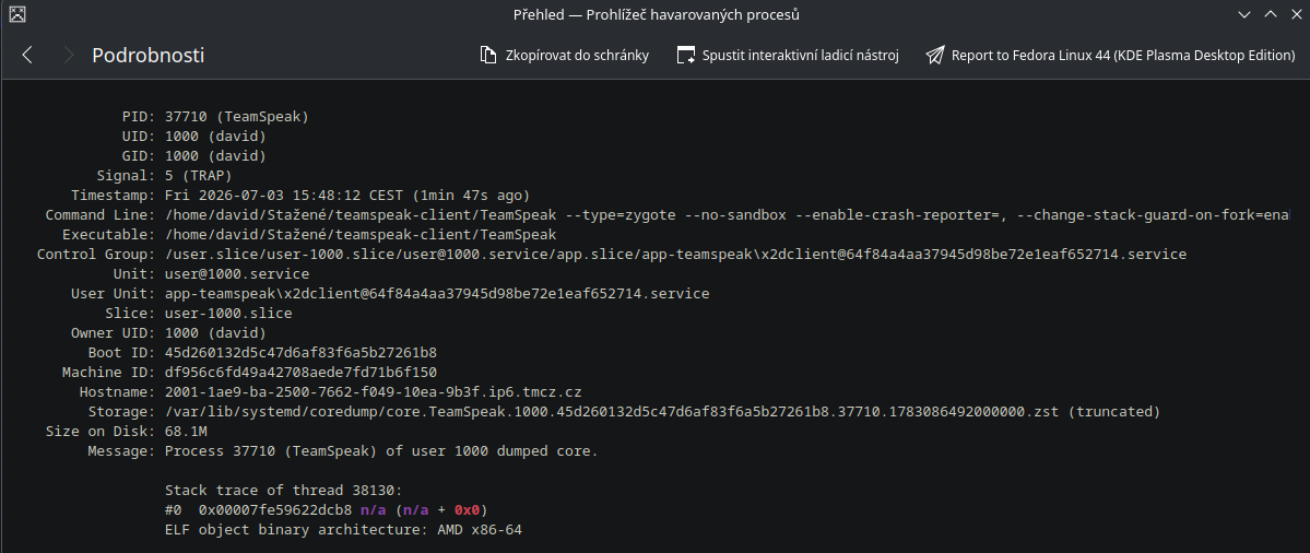

Terminal log:
david@2001-1ae9-ba-2500-7662-f049-10ea-9b3f:\~/Stažené/teamspeak-client$ ./TeamSpeak
\[FFmpegDynamicLib\]\[INFO\] system libva pair (with vaMapBuffer2) loaded from /lib64
\[FFmpegDynamicLib\]\[INFO\] loaded bundled FFmpeg from /home/david/Stažené/teamspeak-client
\[74920:74920:0703/155406.128491:ERROR:../source/chromium/src/base/memory/shared_memory_switch.cc:289\] Failed global descriptor lookup: 7
\[74918:74918:0703/155406.419137:ERROR:../source/chromium/src/media/gpu/vaapi/vaapi_wrapper.cc:1640\] vaInitialize failed: unknown libva error
\[74918:75023:0703/155409.659507:ERROR:../source/chromium/src/components/viz/service/display/display.cc:298\] Frame latency is negative: -0.016 ms
\[75110:75110:0703/155411.165416:ERROR:../source/chromium/src/base/memory/shared_memory_switch.cc:289\] Failed global descriptor lookup: 7
\[75111:75111:0703/155411.168150:ERROR:../source/chromium/src/base/memory/shared_memory_switch.cc:289\] Failed global descriptor lookup: 7
\[2026-07-03 15:54:15.715\] \[info\] \[shutdown\] watchdog armed, deadline 15000ms from now
\[74974:74985:0703/155415.725564:FATAL:../source/chromium/src/third_party/webrtc/rtc_base/platform_thread.cc:181\]
# Fatal error in: ../../../source/chromium/src/third_party/webrtc/rtc_base/platform_thread.cc, line 181
# last system error: 0
# Check failed: 0 == pthread_join(\*handle\_, nullptr) (0 vs. 35)
\[2026-07-03 15:54:15.757\] \[info\] \[shutdown\] monitor_stop took 0ms
\[2026-07-03 15:54:15.758\] \[info\] \[shutdown\] myteamspeak_stop took 0ms
\[2026-07-03 15:54:15.758\] \[info\] \[shutdown\] tschat_stop took 0ms
\[2026-07-03 15:54:15.758\] \[info\] \[shutdown\] clientlib_finalize took 0ms
\[2026-07-03 15:54:15.758\] \[info\] \[shutdown\] pipe_controller_stop took 0ms
\[2026-07-03 15:54:15.759\] \[info\] \[shutdown\] io_service_stop took 0ms
\[2026-07-03 15:54:15.759\] \[info\] \[shutdown\] binding_residual took 0ms
\[2026-07-03 15:54:17.759\] \[info\] \[shutdown\] P3 close-cycle deadline hit; forcing CefQuitMessageLoop
pool dtor
Crash:
Attaching a core dump: Portal4Gamers
