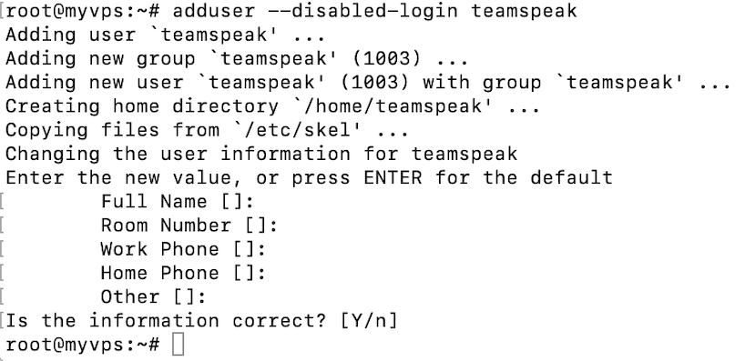

I did the steps set forth in tht tutorial I linked in a previous reply. I created the teamspeak user, then I downloaded the server with wget. Then I extracted the contents of the tar file, and removed the .tar.bz2 archive. Then I nabigate into the directory that resulted from the extracted archive, and created the file to accept the license terms. Then I create the system file. Last night I started it with the script, and did the step to retrieve the privelige key, and it let me do it. But when I put in my server’s hostname to start working on the server, it wouldn’t connect.

it seems like you try to start the server with a user wich does not have the proper rights or something i guess?
maybe this will help for you as it did for some of my friends:
sudo -i
apt update
apt -y upgrade
apt -y install wget bzip2 tar ca-certificates
adduser --disabled-login --gecos “” teamspeak
mkdir -p /opt/teamspeak
chown teamspeak:teamspeak /opt/teamspeak
TSVER=“3.13.7”
cd /tmp
wget -O “ts3server_${TSVER}.tar.bz2” “https://files.teamspeak-services.com/releases/server/${TSVER}/teamspeak3-server_linux_amd64-${TSVER}.tar.bz2”
tar -xjf “ts3server_${TSVER}.tar.bz2” -C /opt/teamspeak --strip-components=1
chown -R teamspeak:teamspeak /opt/teamspeak
sudo -u teamspeak touch /opt/teamspeak/.ts3server_license_accepted
sudo -u teamspeak /opt/teamspeak/ts3server_startscript.sh start serveradmin_password=‘DEIN_STARKES_PASSWORT’
THIS IS NEEDED TO GET SERVER ADMIN ACESS TOKEN :
sudo -u teamspeak tail -n 80 /opt/teamspeak/logs/ts3server_*.log
sudo -u teamspeak /opt/teamspeak/ts3server_startscript.sh stop
apt -y install ufw
ufw allow 22/tcp
ufw allow 9987/udp
ufw allow 30033/tcp
ufw allow 10011/tcp
ufw --force enable
ufw status verbose
