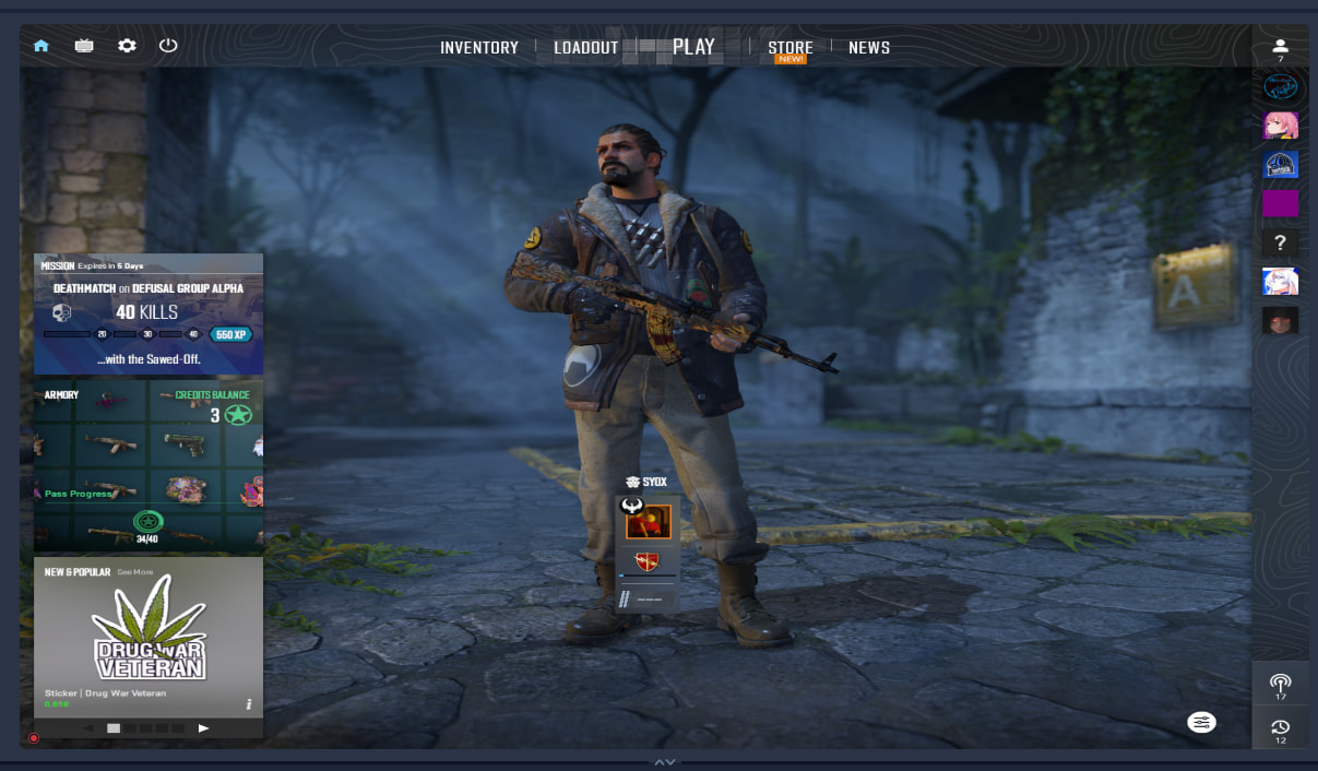

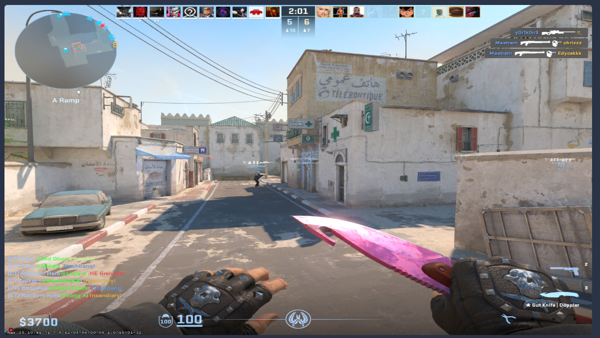

Here are screenshots while screensharing in TS6 connected to an official VAC Protected Server, with no errors occurring at any point during the match, or even afterwards in the main menu.
