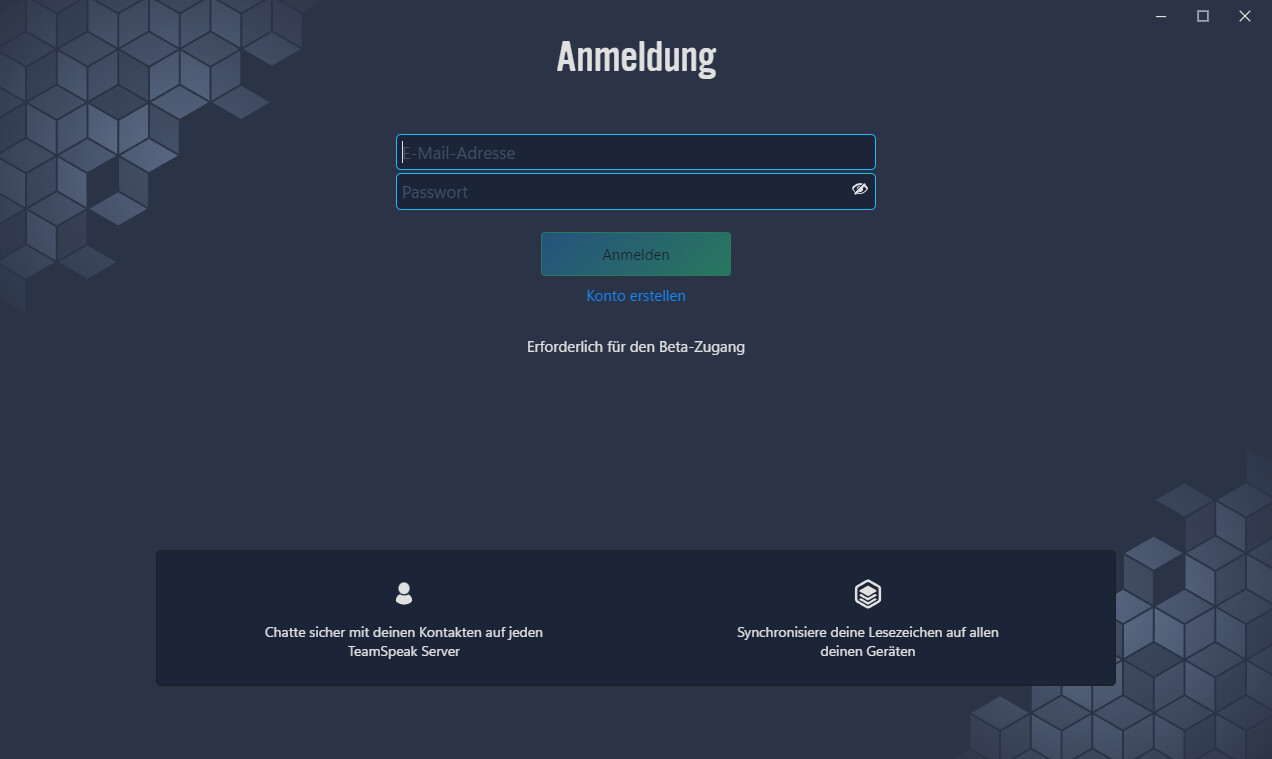

Can you please post a screenshot of the login page for me to verify that you’re using the correct version?

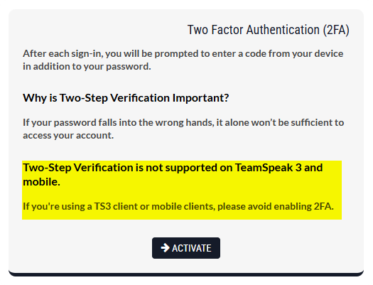

Have you enabled 2FA for your account?

If it still does not work, please post a picture of the login menu with the error message for me to verify that you’re on the correct version.
Or to use TS3 you will need to disable the 2FA. Like mentioned on the myTS website
this is the actual version
can you see the screenshot it dissapeared.
Okay, this may be a bit confusing but the Version shown in the Installed app list is not corresponding to the actual Version you have installed. Please go ahead an use the installed I’ve linked above.
Yes, I saw the screenshot and hid it because it contained your email.
Well its a different version now but if i try to log in nothing happens, no error.’
sign in buttons lights up and the teamspeak logo comes up but no error and log in doesnt happen
Yes that is the correct login page.
Now please try disabling the 2FA and see if the login works. At this time of development the 2FA was not implemented so it should work after disabling it.
It works, thank you.
https://files.teamspeak-services.com/pre_releases/client/5.0.0-beta77/teamspeak-client.msi
!!NO 2FA!! log in and everything is fine.
Thanks for the feedback, I’ll add that info to my post.
Since we’ve just released the 2FA, I as not aware of that issue.
