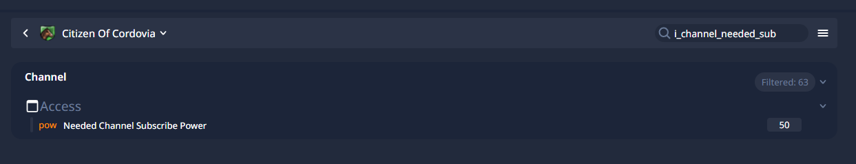

I’ve set i_channel_subscribe_power to 50 and i_channel_needed_subscribe_power is 2 and I’m getting the same error as before

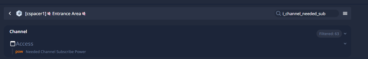

I just did that but I do have some channels like spacers with higher i_channel_needed_subscribe_power as 70but everything else as 2 and it’s still giving the same error
Yes that is in this case causing the issue, as the users do not have enough permissions to view the spacers.

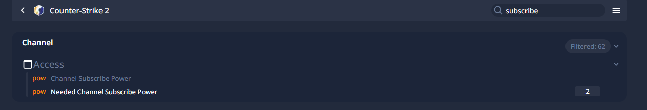

I set i_channel_needed_subscribe_power to 2 on every channel and the same error happens. I then tried removing that permission on every channel and the same error happens
If a channel has 2 of needed permission, then the users needs a i_channel_subscribe_power of at least 2 to not receive this error.

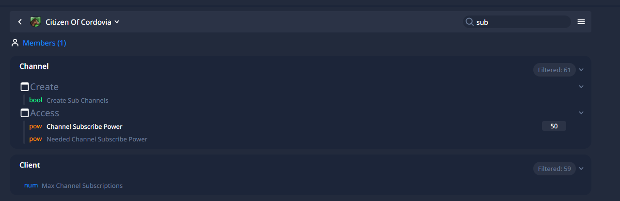

I have the group on 2 and the channel on 2 for every channel so I’m very very confused
Please share a screenshot of an example channel as well as the group - use the search therm “subscribe”
And the user that is has the error is assigned to the group “Citizen Of Cordovia”?

In the Server Group, right click the permission and click “Add Skip Flag”
Does this change anything?
No
