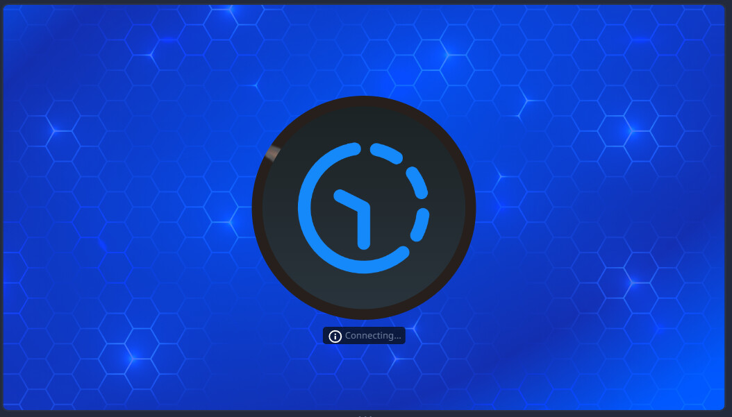

I’ve got a problem with the video streaming feature when trying to join a video stream in a private chat or group chat with a contact.
I’m trying to connect to the stream of my friend, but it says “Connecting…” far too long and after a little more waiting the “join” button on stream appears again, but when trying to join again, this time this error appears: “Failed to join stream: Screen Share session already registered”.
When closing TS6 and trying it again after a reopen, it still doesn’t work. This only happens with one of my two contacts. But this specific contact has the same problem with my stream.
My other contact is able to watch my stream without any problem and I also can watch his stream.

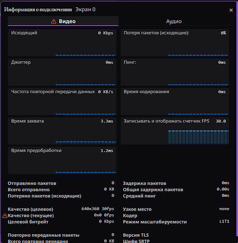

I am experiencing a very inconsistent issue with screen sharing in TeamSpeak 6.
When I start sharing my screen, the stream may work normally for some time, but then suddenly drops to 0x0 resolution, 0 FPS, and 0 Kbps upstream. At that point, the stream essentially stops sending any data.
The behavior is extremely inconsistent and I have not been able to identify a reliable pattern. It can sometimes even change when I interact with the TeamSpeak client itself. For example, simply moving the TeamSpeak window to another monitor can sometimes cause the screen stream to stop working.

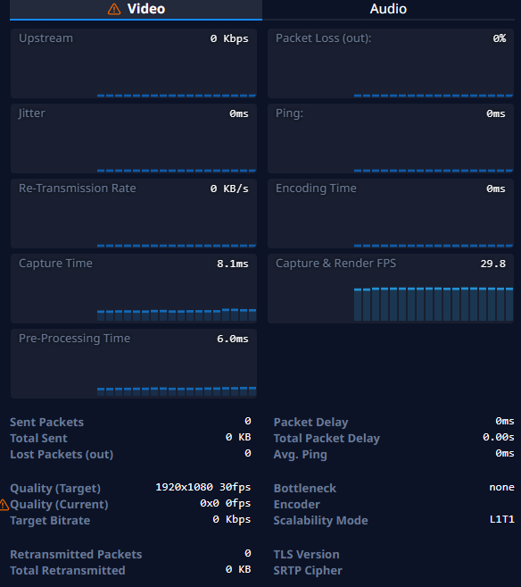

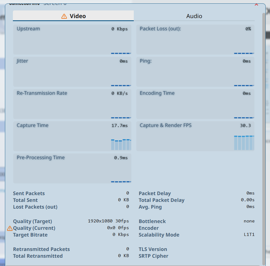

0x0 suggests there’s a problem with the decoder. Or that no viewers have joined the stream yet. What’s the situation on the viewers’ end? Do they just see a gray screen, or are they still trying to join the stream and are stuck there? Have the people watching tried different decoders yet?
This is what a stream info looks like when no one is watching yet. Is it the same for you, or is the “target” at the top already 0x0 for you?
With the next update you will be able to set a custom port range, maybe that helps until the SFU releases (if the problem is p2p related and not encode/decoder specific)
I’m actually experiencing all three situations.
Sometimes the viewer sees a gray screen, sometimes another person just gets stuck loading, and occasionally someone can actually see my screen, but then the stream suddenly freezes. When that happens, the stream goes to 0x0, 0 FPS, and the bitrate drops to 0 Kbps or fluctuates between around 10–100 Kbps.
And regarding your screenshot, yes, mine also shows 0x0 and 0 FPS even when nobody is watching my screen.

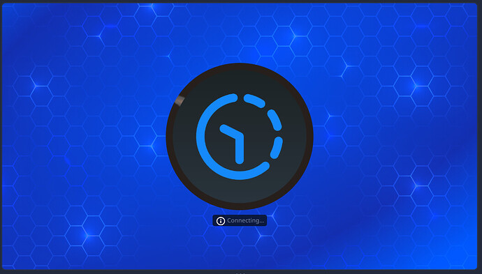

I can’t view shared screens in TeamSpeak 6. When I click to watch, it just stays stuck on “connecting” indefinitely. I tested the screen sharing feature on another network and it worked, but for some reason, it simply doesn’t work on my main network. Here are some things I’ve already tried:
. Disabled the network/Windows firewall
. Changed the DNS
. Disabled the router firewall
. Disabled the router’s ALG
Nothing seems to work. I can hear others via voice chat, but I’m unable to use the screen sharing function. Can anyone help me?

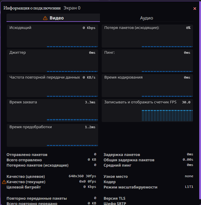

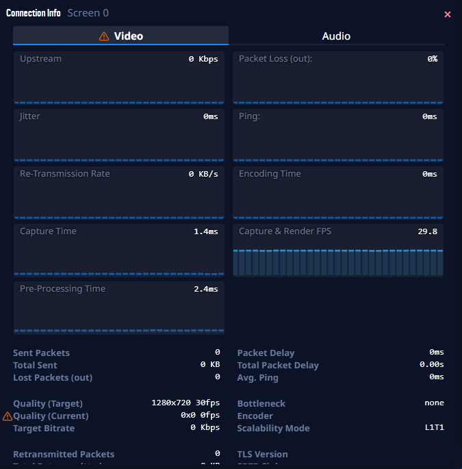

on connection info
its saying Quality (current ) 0x0 0fps and target bitrate 0 kbps

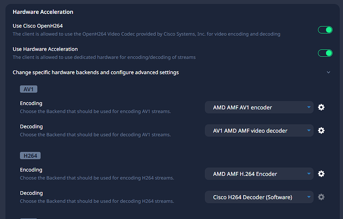

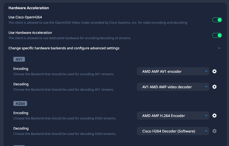

My OS is WIN1, GPU AMD RX 9060XT, client version is 6.0.0-beta4.1

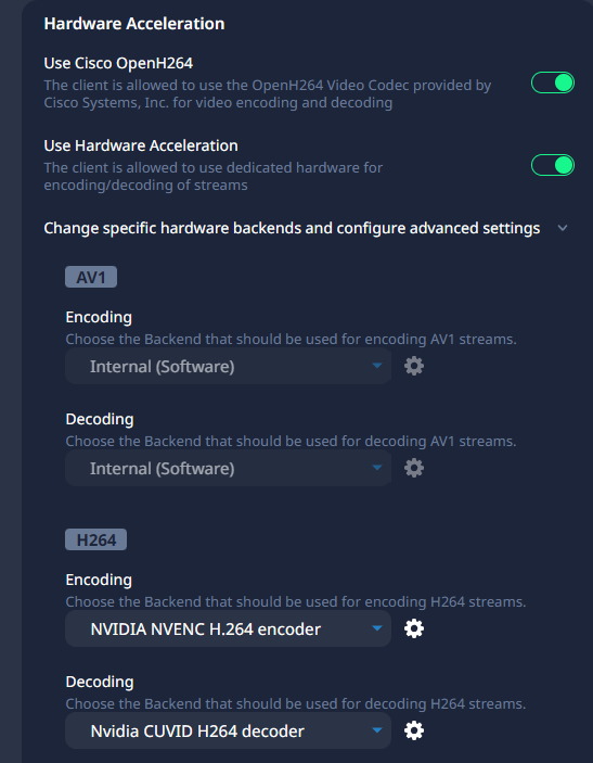

Could you open Settings → Video and expand the advanced hardware backend settings?
I am mainly interested in which encoder TeamSpeak is using for H.264 and AV1 with your RX 9060 XT. If possible, post a screenshot of that section.
