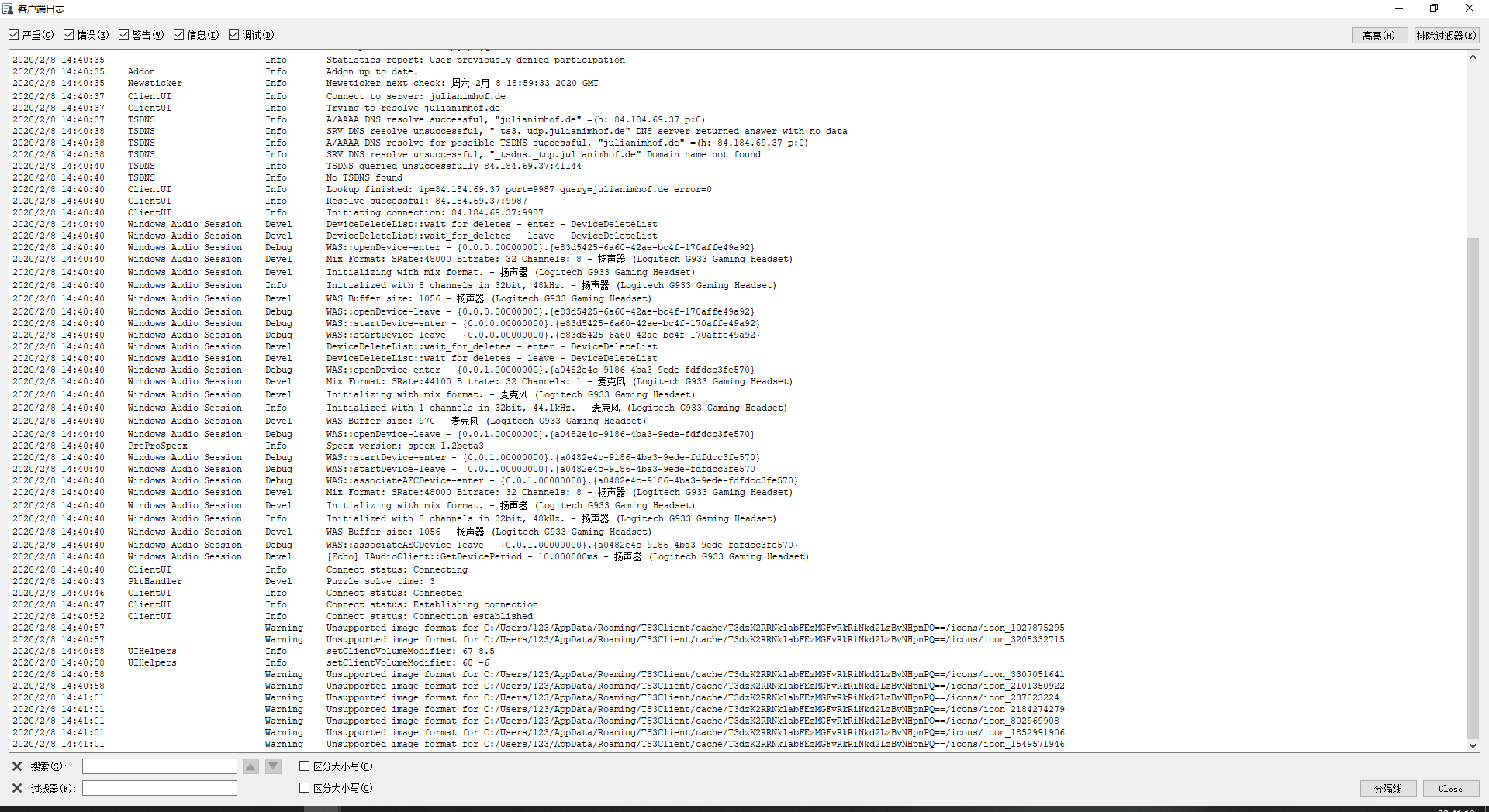

This is the Client Log.
ok, thanks a lot, i can now join the server through your proxy, you are amazing.
