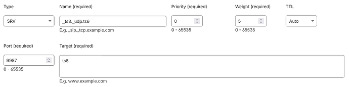

Hello teamspeak community! Like many others, I am interested in hosting my own teamspeak server after the recent changes Discord is threatening but am having trouble accessing my server remotely. I have an unraid server running the teamspeak 6 container and have no issues accessing it via my server’s IP locally. I have a VPS with Pangolin that is serving up a few different services, with DNS provided by Cloudflare pointing to my domain. In Cloudflare, I have created the following SRV entry:
I have a wildcard entry with my server’s IP but also created a CNAME entry in case, which is ts6.mydomain.com.

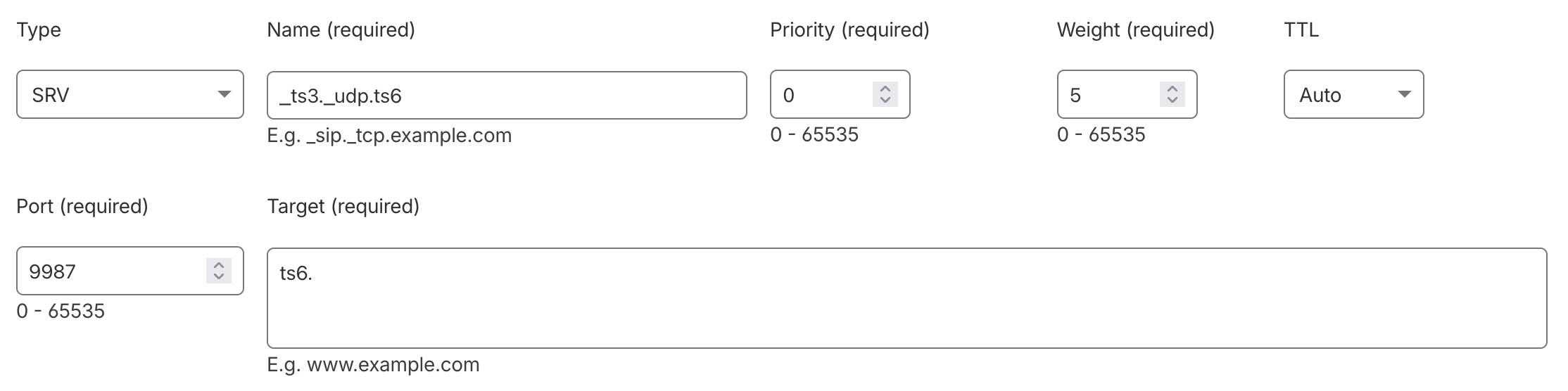

2. If you are using your own domain, create a SRV record with your DNS provider as outlined here: https://community.teamspeak.com/t/ts6-srv-record-adding-a-custom-domain-to-a-ts-server/61045 I use Cloudflare, but other providers should be similar. Also create a CNAME for “ts6.yourdomain.com
