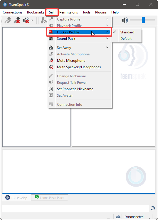

Another possible cause of the issue can be your hotkey profile. If the wrong hotkey profile is selected in the settings, your hotkey will not work.
Do the following to check your Hotkey Profile:
SelfHotkey Profile → select now the correct Hotkey profile, that you have created Hotkeys for. This is however just a temporary fix and will be reset to default once you reconnect.

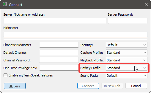

To fix this permanently you need change the settings either in of the connection window (CTRL + S)

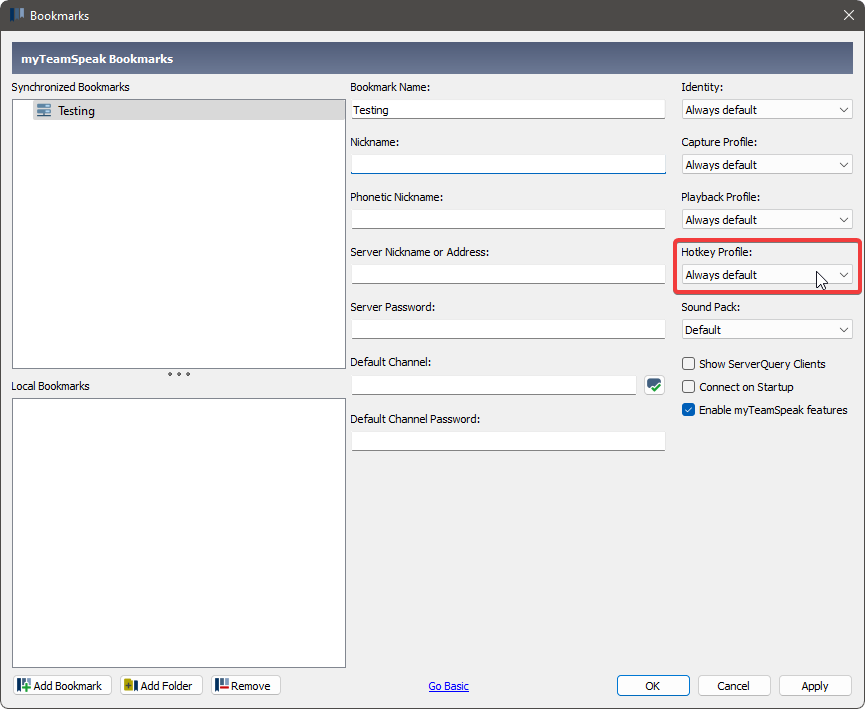

or if you are using a Bookmark to connect to the server it needs to be changed in the Bookmark settings (CTRL + B)

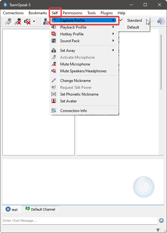

SelfCapture Profile → and select the default profile. If it is not there check your capture settings. Inside of the settings ALT+ P

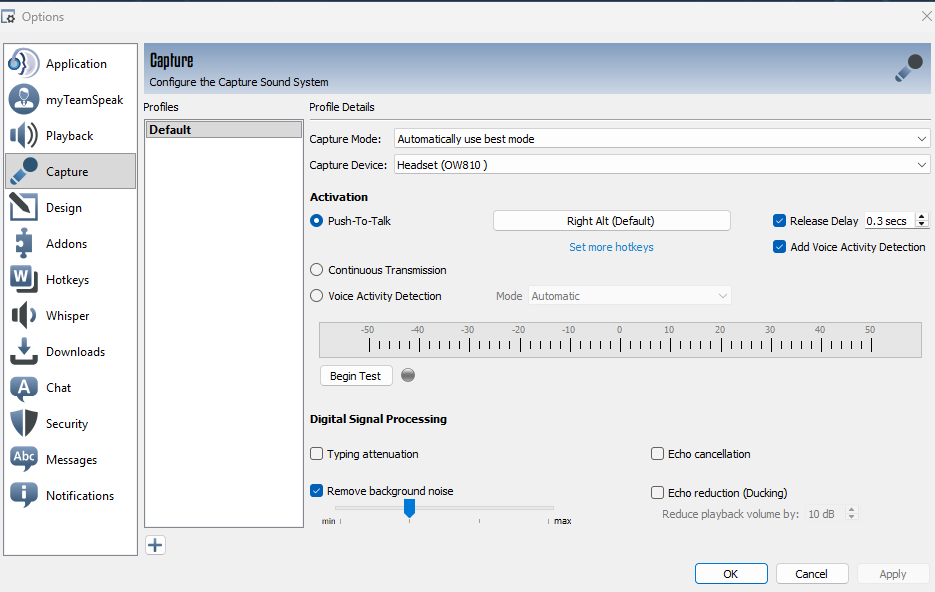

  1. The options window will pop up. Switch to the Capture tab.
    2.. From there, choose the correct capture device or your capture profile.
3. Uncheck ‘Voice Activation Detection while Push to Talk’ Option
For some users, the issue was caused by the Voice Activation Detection while Push to Talk option. What this option does it enables Voice Activation Detection for Push to Talk. This means that the mic will not activate even when you have pressed the push to talk hotkey unless the voice is of a certain level.
This option is found in the Advanced options under the capture device settings. Disabling this is likely to fix your issue if the above solutions have failed to do so. Here’s how to uncheck the option:
ToolsOptionsCaptureAdvanced Options → From the newly listed options, make sure that the ‘ Voice Activation Detection while Push-to-Talk ’ option is unchecked.
  1. Finally, click Apply and then hit OK .

Check your Hotkey Profile
Another possible cause of the issue can be your hotkey profile. If the wrong hotkey profile is selected in the settings, your microphone will not activate and hence prevent you from communicating with others. Therefore, you will have to make sure that the correct hotkey profile is selected if you have created one. Otherwise, you will have to make sure that the correct hotkey is assigned to the push to talk option. Do the following to check your hotkey profile:
  1. To check your hotkey profile, click on the Self option in the menu bar of Teamspeak.
  2. After that, move your cursor to the Hotkey Profile option and make sure that the correct profile is marked.

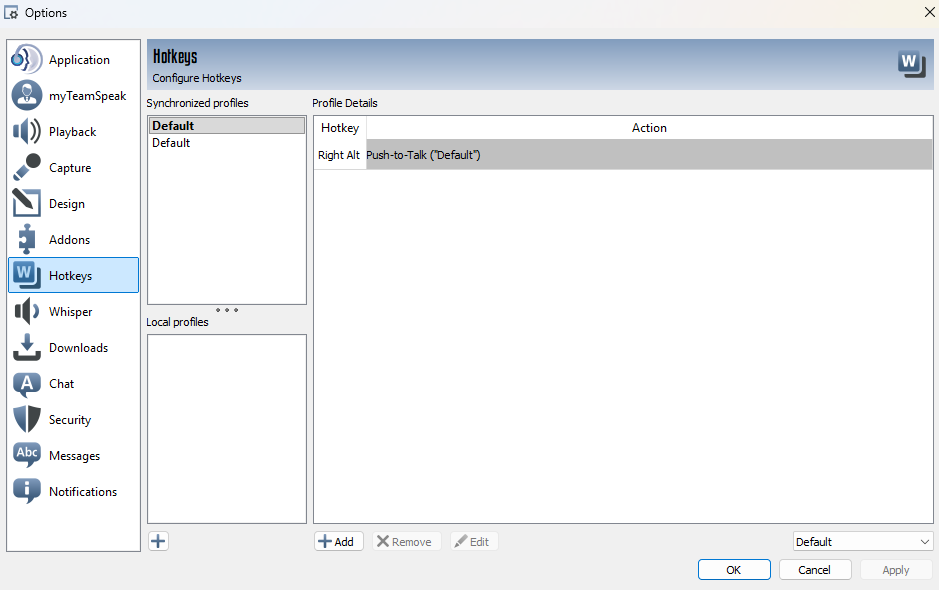

  3. Alternatively, you can go to the Tools option and then select Options from the drop-down menu.

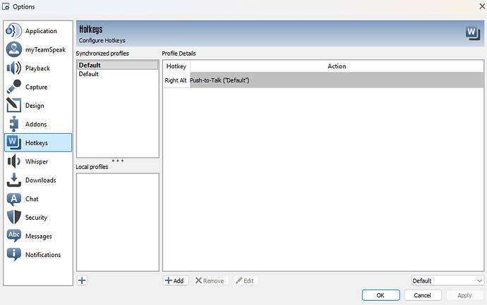

  4. Afterwards, switch to the Hotkeys tab and make sure that the correct profile is selected.
