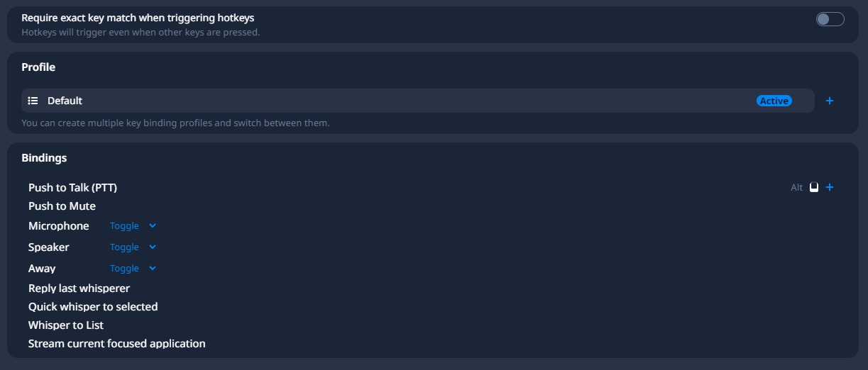

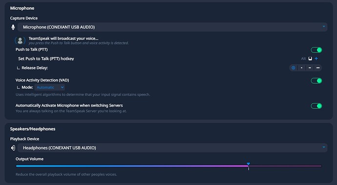

Could you please share your audio settings as well as your hotkeys attached as a screenshot?

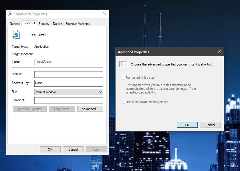

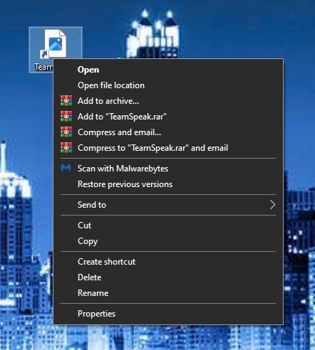

Right click the desktop shortcut and click run as admin

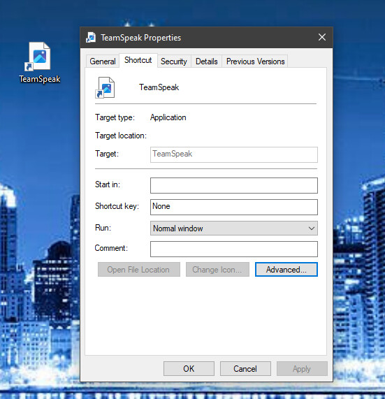

That is not an option, as there are no Compatability Tab options in the submenu.

Why are your icons not loading?
And why does the shortcut not tell the start in location?
The run as admin is probably not shown as you seemingly don’t have admin permissions with your Windows user account.
