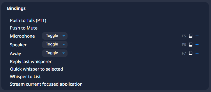

I came across the fact that the bind/hot key assigned to mute the microphone only works when the Teamspeak application is running and you are in it.
If you go to any game or go to any other application, the hotkey does not work. But if Teamspeak is minimized and you are not in the game, the keyboard shortcuts work.
It’s very inconvenient. You have to go back to the app every time to mute the microphone using a hotkey.
Can you make the hotkey work even when Teamspeak is running in the background?
