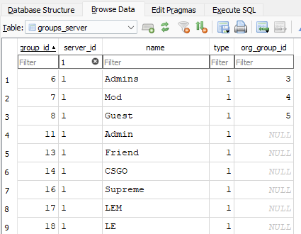

:white_check_mark: Step 1: Export from the old database
  1. Install and open DB Browser for SQLite.
  2. Click Open Database, navigate to your prepared folder, set file type to All Files, and open the ts3server.sqlitedb file.
  3. Go to File → Export → Tables as CSV file.
  4. While holding Ctrl, select the following tables:
  • channel_properties
  • channels
  • groups_channel
  • groups_server
  • perm_channel
  • perm_channel_groups
  • perm_server_group
  • server_properties

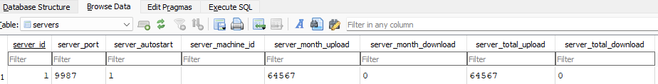

    Thats because you can have multiple virtualservers!
    Look into the TS6 DB under the table Servers it should only have one entry and the server_id should match up with the ones in all the other tables!

good that you point that out i guess its because you can have multiple virtualservers.
what you can try:
look into the TS6 DB under the table SERVERS it should only have one entry and the server_id should match up with the ones in the other tables!
hope that helps
Hi mate,
That was indeed the problem, should’ve figured out that one myself… :smiley:
Thanks a lot for your quick response! <3

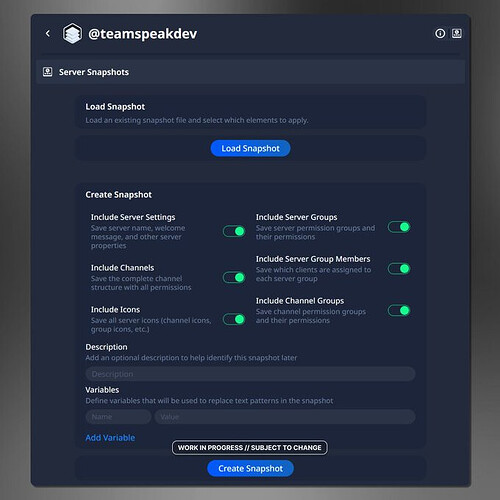

Just to chime in and say, that the mentioned approach is unsupported as it requires manual database modifications. We are working on a new way to easily apply Server Snapshots to a server:
Server Snapshots allow simplified server migrations and backups: Even without a query, you can now create and restore server snapshots, including channels, permissions, and more, via the server context menu.
Currently in Alpha Testing

Hello, the snapshot feature is great; however, it runs into issues at the following point:
  • Server Groups: If the “Assign server group members” option is enabled, the import process hangs and displays an “Invalid parameter” error. If this option is left disabled, the import works, but a very important element is missing.
Thank you very much, and have a great day.
