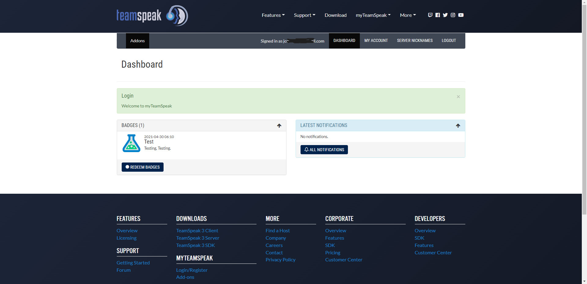

Are you able to access https://myteamspeak.com in your browser?
yes its ok
