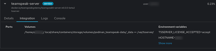

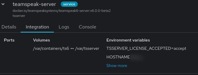

I’m having an issue getting my rootless podman storage to work quite right.
If I use this “teamspeak-data” identifier, it successfully launches the container but the storage is under ~/.local
If I replace that line with:
volumes:
  - /var/containers/ts6:/var/tsserver:z
Then the server fails to launch and says it has issues hitting /var/tsserver
Would you know how to map that teamspeak-data to my desired /var/containers/ts6 ?
Thanks!

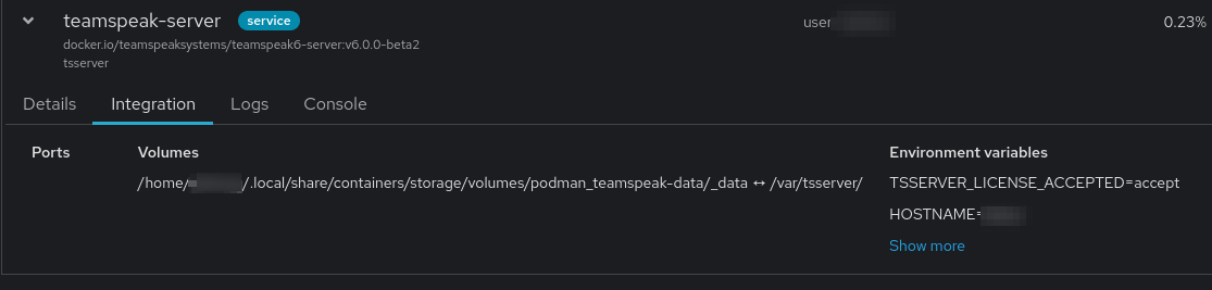

Desired:
What happens when I use:
    volumes:
      - teamspeak-data:/var/tsserver/
volumes:
  teamspeak-data:

I faced that issue too. I am actually using the default volume of podman. But my guess for that error is a permission mismatch between volume within the container and the directory outside of it. I would suggest to exec -it into the container and get the UID of the user. After that, I would chown the directory according to that user id. Group can be as present.
All the best.
