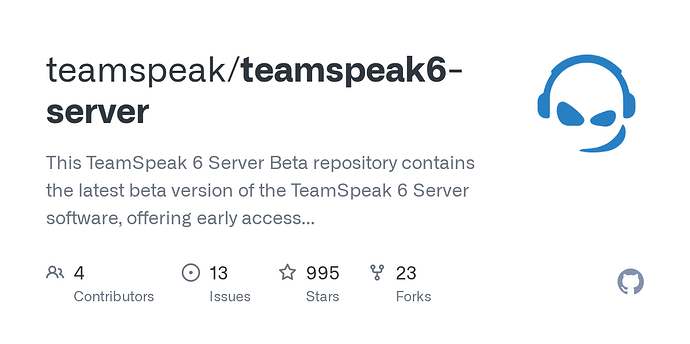

Server sided configuration is explained here:

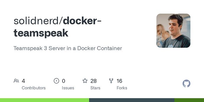

The official instructions are here. But, personally, I used solidnerd/docker-teamspeak instead. Note that I couldn’t get volumes working without switching to using a MariaDB container for the database, YMMV.

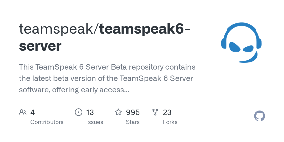

Firstly a correction: if you want to run a TS6 server (eg for screen sharing) you want the instructions here, which are much more complete.
You don’t need to update any IPs or anything like that. Set up the docker compose file and run it, and it should be accessible straight away.
I switched to a TS6 server yesterday without issues (outside of having to use SQLite instead, which, hey, I wanted to do in the first place).
In addition to the github guide, the docker container when first run will have logs including server admin rights token and server query admin account credentials (that I don’t know how to use yet). Just store those as they only appear on the first run. You need the token so when you first connect, you can claim the server as its admin.
Also, the teamspeak-data docker volume I think should be in “/var/lib/docker/volumes/teamspeak-data”, in case you want to backup the server data (assuming just copying these files will be enough to restore).
