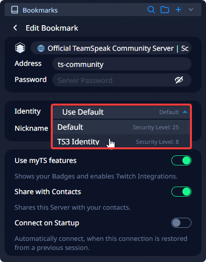

If you’re connecting trough a Bookmark, check the setting.
Right click the Bookmark → Edit. Here check if the correct Identity is selected.
To change the default Identity you’re using to connect to all Servers, open the SettingsIdentities → Open the drop down menu and select the correct Identity and choose Use as Default

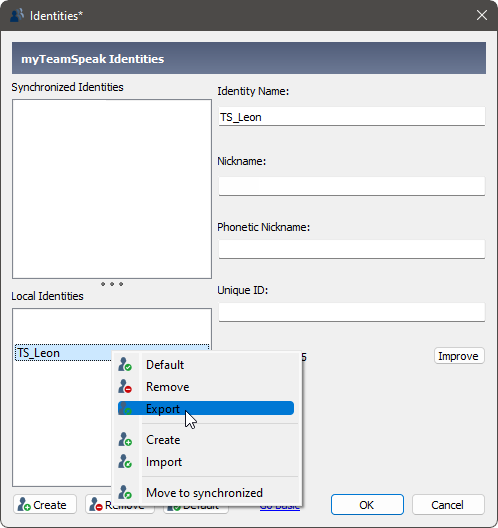

Exporting the Identity from TS3 is only necessary if it has not been synchronised with myTS prior.
To export an identity from TS3, open the Identities menu.
ToolsIdentities or use CTRL + I

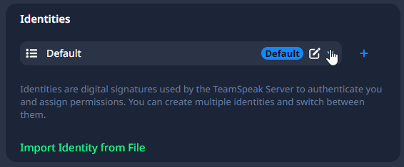

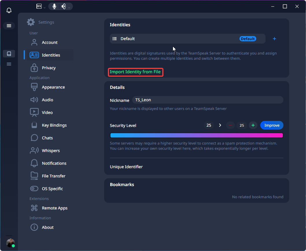

To import them to TS6 open the SettingsIdentities
In the drop down menu you can then decide which identity you want to use by default for connecting to servers.

You can export the bookmarks from TS3 and import them in TS5. The bookmarks are not shared across the two programs as they are using different databases.

From your linked GitHub issue your bookmark identity settings seem to have changed.

Hi, i generally use TeamSpeak 3 when i play games but to do detailed customization in my server like icons i wanted to use TeamSpeak 6 since TS3 does not support file transfer. But when i connect to my server via TeamSpeak 6 and with my account i do not look as owner. I tried to export my .idi from TS3 and import it to new TeamSpeak but didnt work.
