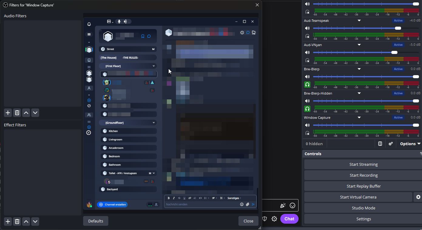

Capture is made with Application Audio Capture it was working the prior version.
But I also tried now to change to Window Capture, same issue TeamSpeak voices aren’t captured only the notifications.
You can see on the screenshot that people are speaking but on the right side nothing is moving at all on the monitors.
