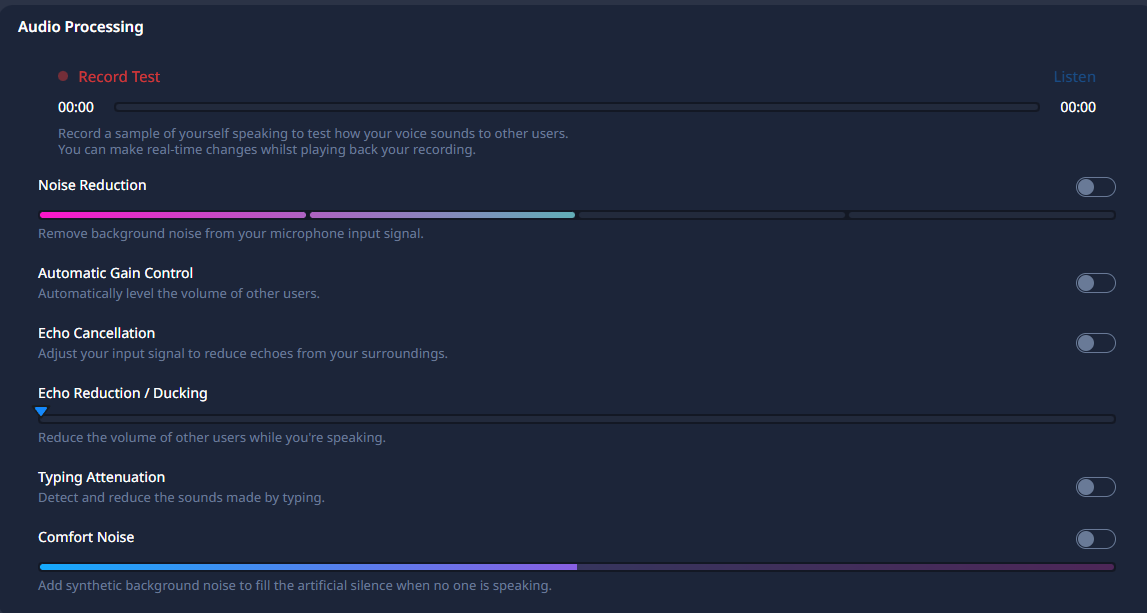

TS5 automaticaly lowers others when i speak (press push to talk). And I can’t find where to turn this off. For my use case scenario this is anoying.
Echo Reduction / ducking in Audio settings does this.
Turn slider to the right in case you do not want any reduction.
Or you have are a priority speaker, in this case your voice is prioritized over others.
Oh. I actually have to pump the bar up to have no effect! It is a bit counter intuitive. :slight_smile:

Settings → Audio → Echo Reduction / Ducking

When I talk other people get quieter. I dont have “echo cancelation” on. I dont have a priority speaker status. I have “do nothing“ in Windows communication settings. Also I have 2 friends: one of them has the same issue, the other one doesn’t. We checked and found out that our settings are the same. I cannot find a solution. Please, help.

Automatic gain control is always on and mutes everyone speaking when my mic goes on. Tested while letting someone speak and gently blowing in my mic. This results in fast turning down / muting everyone in my channel. which is unusable, especially with voice activation.

You need to move the Echo Reduction / Ducking slider to the right side.
well well. that makes sense :slight_smile:
very confusing if I do not know what it does and tick it to test and forgett xD
Also the second reply from @LeonMarcelHD makes sense to actually set the duck if we want one. very nice.
