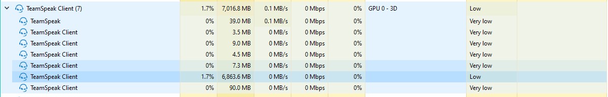

max memory useage is 7gb power useage is very high

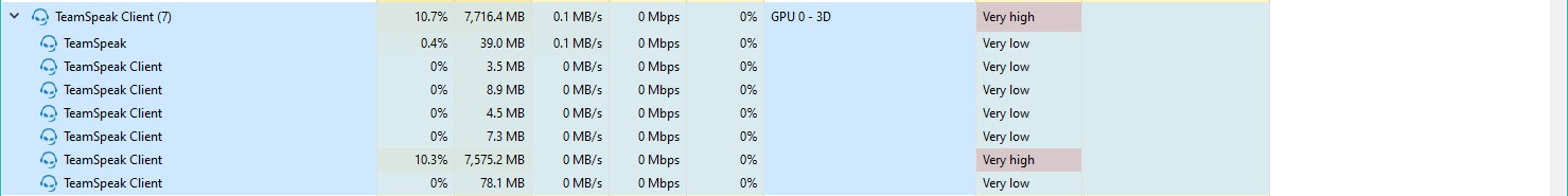

also it seems i have 6 ts5 clients running on on task manager and one listing as teamspeak as drop down list shows

The “Power usage” appears to be just an arbitrary thing Microsoft made up somehow for some reason. It doesn’t seem to mean anything, other than maybe “this appears to be a very active process”. At least that’s my understanding of it. I have processes that have been idle not using any CPU and a mere 30 MB of RAM for the past 6 hours, yet they are still displayed as “Very high”, presumably because they used like 10 gigs of RAM and 20% CPU for a few hours before.
As for the memory usage: If you’re seeing a lot of animated images or a very large one (dimension / file size wise), then more resource consumption (both CPU / Memory) is expected.
As for the 7 processes, they all belong to the one instance of the TeamSpeak client you have open. TS5 is multi process, so 7 processes is exactly what is expected from a properly working TS5 client at the time of writing.
