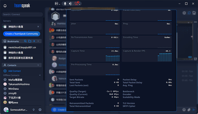

Poor screen share performance when using Intel ARC
Streaming performance is very poor.
Whether or not hardware acceleration is used.
Lower then 60 fps
My pc:
AMD Ryzen 5 7500F 6-Core Processor
32.0 GB 5600Mhz Memory
Intel(R) Arc(TM) B580 Graphics

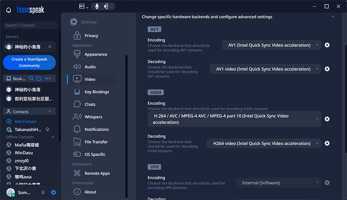

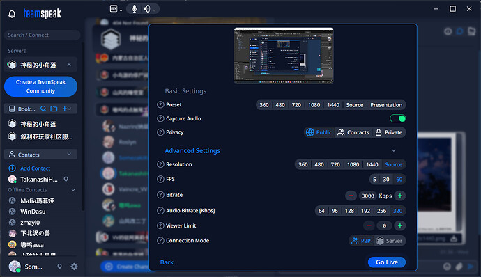

What settings are you using for streaming?
Have you changed any advanced settings in the Video tab of the settings?
advanced settings all defaults
One more thing to add: the frame drops already start just from the preview screen, and the overall system frame rate becomes very low.

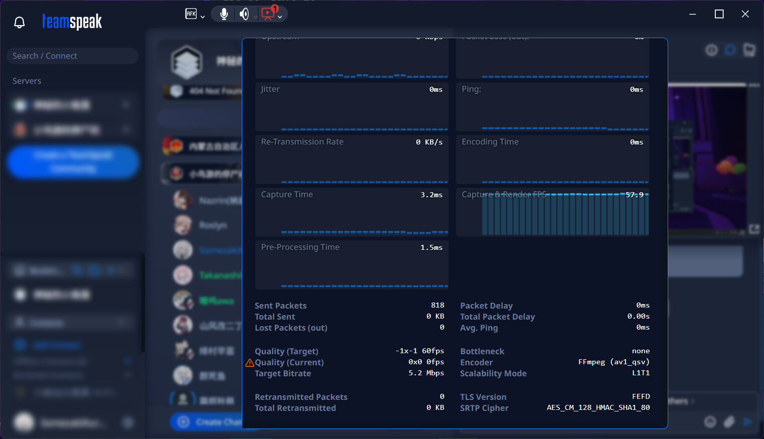

Can you feel a difference in performance with the latest version (beta4)?
We’ve made some adjustments for QSV
The performance is better, but idk why my stream only has audio and no video.
ok, is network issue
