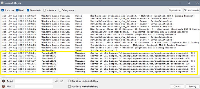

If TS3 Client sync is activated I am getting this error several times a day :
27.05.2026 13:34:01 ProtobufRPC Warning Server at URL https://clientapi.myteamspeak.com/synchronization responded: 400
The requests are idendical but one time it it 200 and the other time 400:

Anyone any ideas ?
Do you currently still get those errors? I can see them in my logs as well, however they are no longer printed as of 1,5h ago.

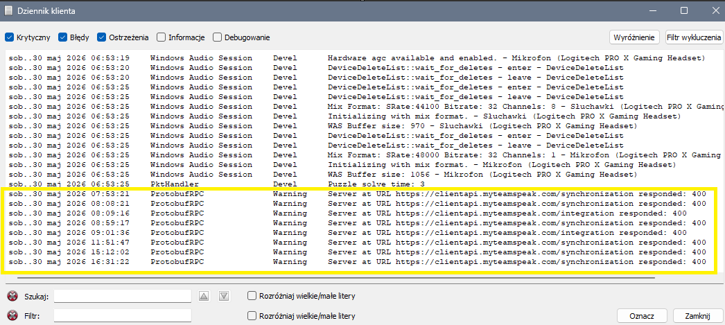

Yeah. It seems it not much more than annoying since everythink works but I have notifications enabled and dont want to disable them. This error will also cause a notification. The timing seems completely irregular. No pattern. Just sometimes.
I confirm. I get these warnings several times a day in Windows 11.
No change after:
it almost seems like api responses are 400 without beeing real 400 responses. since they are the same as the 200 responses
The myTeamSpeak account errors have stopped appearing on my end. I haven’t seen any errors in the logs for some time. If others can confirm the same, we can consider this topic resolved.
