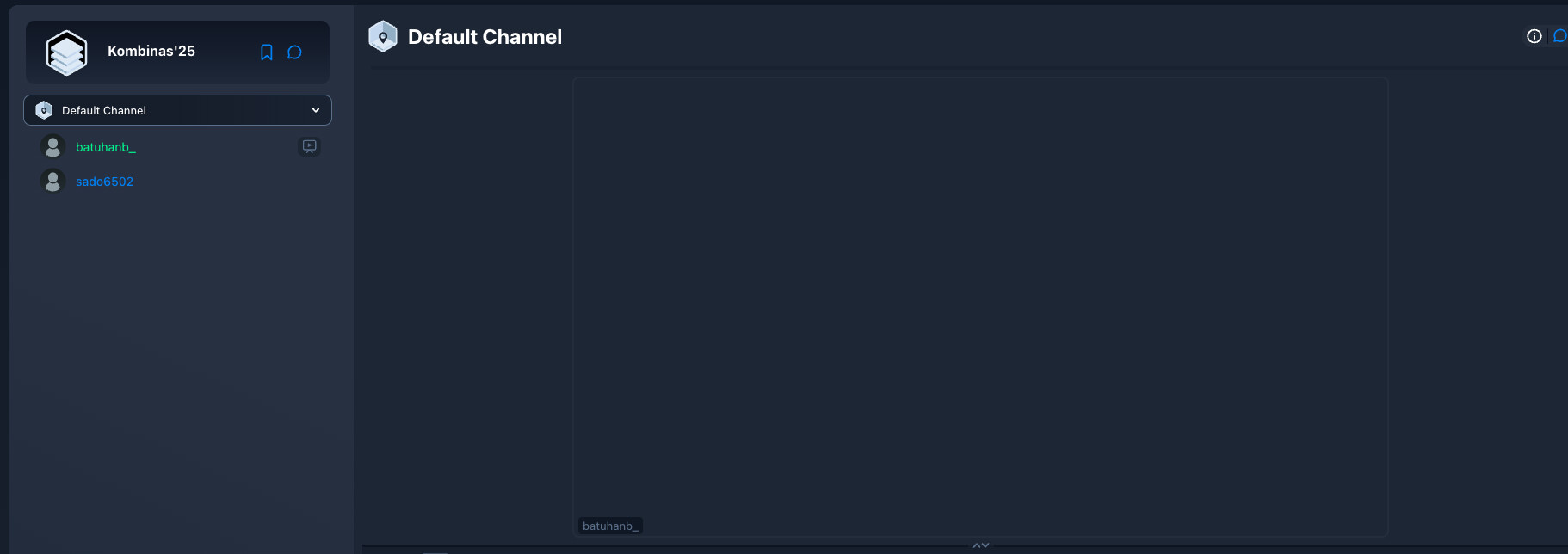

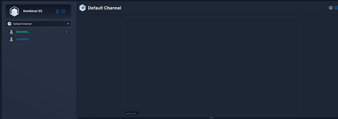

Hello as you can see this is what i see:

Are you able to start a stream that other friends can view?
Is this an issue which always occurs or is it just sometimes happening?
As of now we don’t exactly know what is causing the issue. The logs are looking fine. Our QA team ran into a similar issue a while back, where he couldn’t join streams and the screen was gray. It turned out that some threads we’re blocking each other and a restart of the client / system helped in this case.

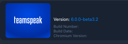

Macbook M2 Pro: Sequoia 15.7.1 (24G231)
TeamSpeak 6 Client: Version: 6.0.0-beta3.2
Build Number: 1760694069
Chromium Version: 140.0.7339.0
