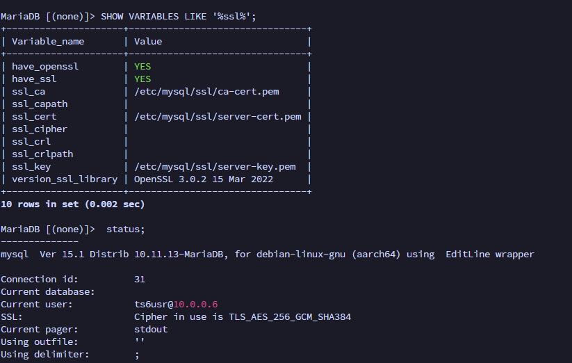

My server was running fine before newest beta9 -patch, newest patch contained libtsdb_mariadb.so. I use MariaDB as db. After updating the server started to require TLS/SSL from my mariadb server. I created self signed certs for mariadb and tested that SSL worked fine with mysql cli. When I tried to start server it refused to start with error Could not connect to mariadb server: TLS/SSL error: Certificate verification failure: The certificate is NOT trusted
I couldn’t find any way to put client cert to server or to bypass cert trust or even tls/ssl requirement.
When I downgraded my server back to beta8 everything worked like a charm when I disabled tls/ssl requirement from server.
Mysql cli shows that SSL works fine:
