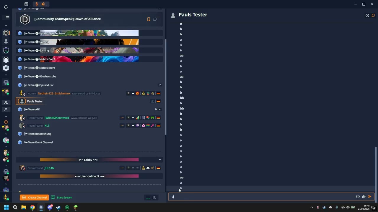

I can confirm that this does happen from time to time: the audio gets quieter and louder whilst I’m actively typing and sending messages. Also happens when TeamSpeak sounds appear from microphone muted for example. See the attached video for this.
