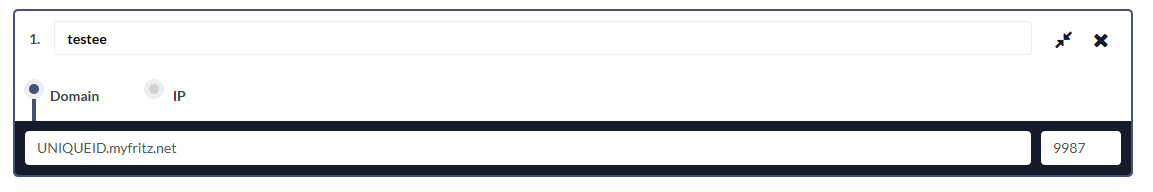

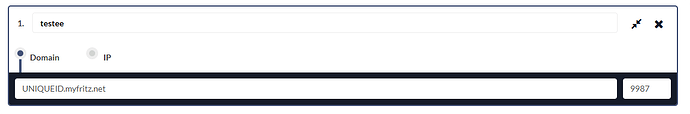

For me it worked just fine.
Just put the domain you’ve received into the server nickname field:
You have a port in the FRITZ dashboard TPC-Port for HTTPS. In my case it was 40177 but it might be different.
If you use this one as the servers voice port and enable the port forwarding, you should then have no issues connecting to the server.
Thank you so much, it worked that way. Why it didn’t work the first time, I have no idea.
