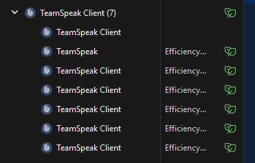

Chipping in again as I had another look at this issue:
In the Win11 task manager, I noticed that only one of the processes were marked with “Efficiency Mode”.
You can toggle this mode by right-clicking each individual process.
I found that by enabling this mode for all TeamSpeak processes, I could now turn off my monitors as expected.
This flag does NOT persist across sessions, so if you restart TeamSpeak or your computer, you will need to set this flag again.
I’ve not found a way to enable this mode permanently for TeamSpeak, might be a task for the devs?
