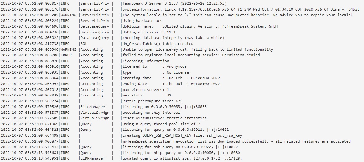

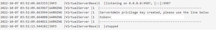

Hello, I hope you are all well. I’ve spent quite a bit of time reading other posts trying to fix the problem I have. Supposedly, you should already have the server running TS3 but when you start the boot process for some reason it stops.
Log 1
Log 2
the installation files
I am doing the installation on Linux and installing the latest version for the date. They could help me because it’s not working.

You have a license problem.
I assume you made a backup, so the old license remains.
You need to change your license.

Did you change the version during installation from 3.13.6 to 3.13.7 or you copied all the steps as written on that link?
Kayien
October 7, 2022, 5:53am
10
Don’t worry I have installed the latest version. I know the document has an older version just walk me through the steps using the latest version

Make sure to copy the server query admin account and token key!
