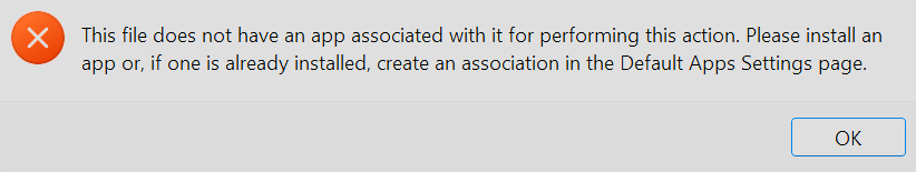

When I claim community I get an error saying there is no associated app for the link. On a different browser this error doesnt appear but the window is blank and nothing happens.

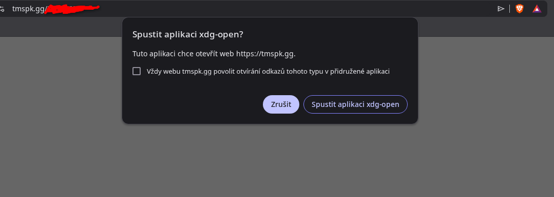

I cant get my create Teamspeak server invites code to work, I post the link on my website. so everyone can join my TS6 server through the website, but link takes me to a blank page. Is there anyway to get a new link for invites so people can join our TS6 server.
But that’s actually correct, teamspeak invite links works like app shortcodes, so there should be popup to transfer the request to the app. If nothing happens, thats it’s due to your browser settings:
Another option would be to enter teamspeak:// in your browser or TS client.

Thank you guy’s for your advise, but neither way worked & using another browser didnt work either
Due to the privacy of his TeamSpeak, we discussed this via DMs, and the redirect on his website as well as self-generated invitation links via tmspk.gg/ and teamspeak:// work for other users.
Currently, when @drummersdream clicks the link, a blank white page opens with a pop-up prompting them to open TeamSpeak. However, after confirming the launch of the client, nothing happens.
