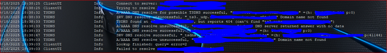

I’m posting this because I don’t know what to do anymore… I’m having issues setting up the SRV records to redirect to the server… According to the logs Teamspeak 3 sees the IP from SRV and then goes to check TSDNS (I have a TSDNS set it up for the server, but there are no records mentioning the DNS domain I’m trying to connect) and then it returns to something like "The TSDNS server “domain.com” doesn’t know “domain.com”, like what?
So, according to what I saw from other posts both of them can co-exist and reason it’s trying to check TSDNS is because SRV record failed.
I tried to find the solution and I saw here in the forums other people had the same issue, but the message is incomplete, it seems they were talking with someone that got the account suspended or deleted so the topics are very vague, really wish someone that could help me because I’m certain someone in the future will look to this same post and find the solution…
I set in the domain a A type and SRV type, should I do something else?
I see in my logs this also: "SRV DNS resolve unsucceful for “_ts3._udp.domain.com”
“No SRV TSDNS found”
then…
“DNS resolve successful, “domain”=IP”
“SRV TSDNS found at “domains”, but could not find TSDNS server there”
my log

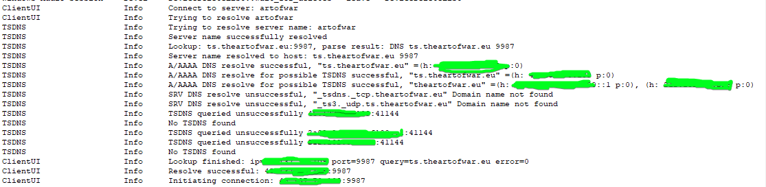

That actually doesn’t help me, since for what I can understand it’s connecting in your server using IPv6 which it’s not my case since I’m trying to use Ipv4 with TSDNS setup… I wonder if I need to port forward TCP for port 9987 as well to make this work, although it should be using UDP not TCP… I port forward the TCP port for TSDNS and it works every time…
This is my log, but like I said for TSDNS it just works SRV record it doesn’t… I wanted to use SRV records since it’s priority number 1, but it seems in my case I cannot…
