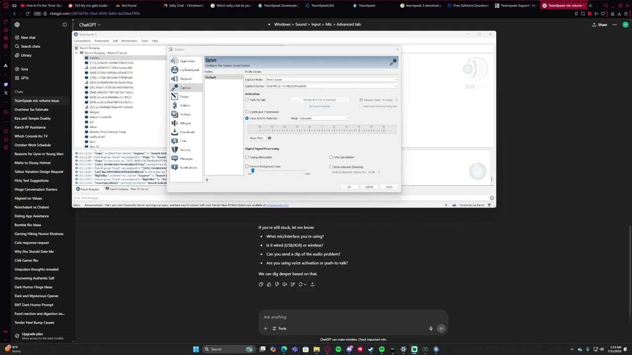

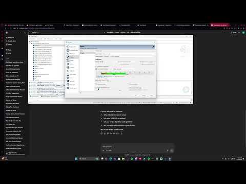

So I’m having this issue where I start a conversation any mic volume is lowish to normal then over the course of about 5-10 seconds it gets louder and louder till its almost peaking (It gets really loud). I have tried a long list of things to try to fix it. It was fixed by going to a really old version of team speak and taking off the auto gain filtering thing on the input section under advanced. But on the more recent TS updates thats not an option and I cant use the old one because the salty chats compatible with ranchRP arent compatible with the old version of TS. Audio clips given for refference… I know a solid bit about audio stuff and im at a complete loss. Thank you for your time. I would have much prefered not to bother you with this. But here we are. (audio for discord and streamlabs dont do this and they have the same source)
Youtube of issue:
Youtube of proof of normal mic function:
Mic is: Shure SM7B with GOXLR

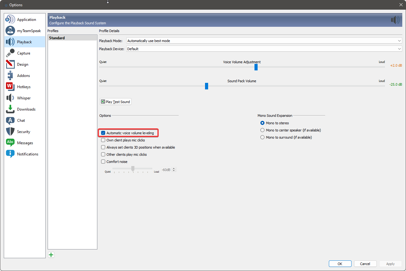

Does it behave the same when turning off Automatic voice volume leveling in the Playback settings?
The first setting Direct Sound is a deprecated software component. Have you tried setting it to Windows Audio Session?
Since a few releases the Automatic voice leveling is in the playback tab settings, rather than being an input setting.
