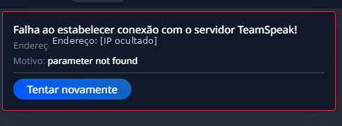

TS6 Client (beta5) fails to connect to TS6 Server (beta12.1) with error "parameter not found" – TS3 connects fine
Hello everyone,
I’m having a persistent connection issue with the TeamSpeak 6 client and would like to know if anyone else is experiencing the same problem or has a solution.
Problem:
  • I cannot connect to a self-hosted TS6 server using the TS6 client.
  • Error shown: “parameter not found”
  • The same server works perfectly with the TeamSpeak 3 client.
Details:
  • Client version: TeamSpeak 6.0.0-beta5 (Windows 11)
  • Server version: 6.0.0-beta12.1 (Linux)
  • Server is using a custom voice port (not the default 9987)
What I already tried:
  • Clean reinstall of TS6 (deleted all folders in AppData, LocalAppData, etc.)
  • Deleted cache
  • Created new identity
  • Tried with VPN
  • Tested using mobile hotspot
  • Confirmed that other servers (including official ones) work fine with TS
    Relevant log lines:
    [info] Connecting to [server]:[port]
    [info] server sent ciphers:1
    [info] Selected cipher:0
    [warning] Error while parsing packet: parameter not found
    [warning] Got command data while disconnected, dropping
    [error] setWhisperReceiveMode: Didn’t find connection for id X
    It seems the client successfully reaches the server and exchanges ciphers, but then fails to parse a packet coming from the server.
    Is this a known compatibility issue between client beta5 and server beta12.1?
    Has anyone else run into this error?
    Any help or information would be greatly appreciated.
    Thank you!

I’m having the same problem how can I resolve it?
Sent me a private message with the affected server and we can see what the problem is.
