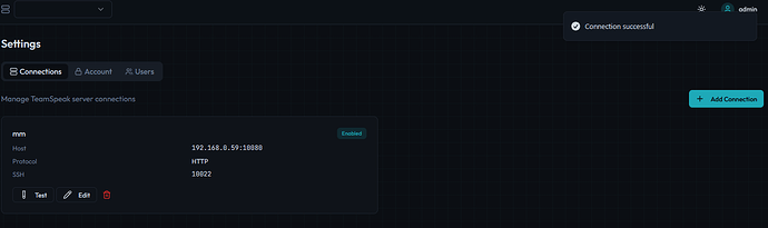

Hello there,
I have exactly the same problem and don’t know how to solve it.
I’ve tried searching and using AI, but nothing works.
It would be great if someone could help :sad_but_relieved_face:
Can you check the connection-window on the Manager? I guess you have Https enablbed (but your server does not have an certificate) just disable https

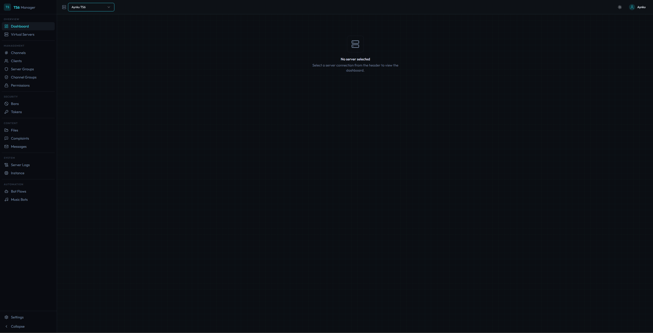

Hello there,

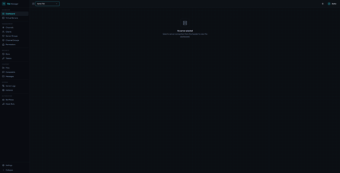

I have the same Problem. I don’t have activated HTTPS. If i Test the Connection, it says me that is all correct. But no Server will show
I use WebQuery HTTPS with self signed certs.

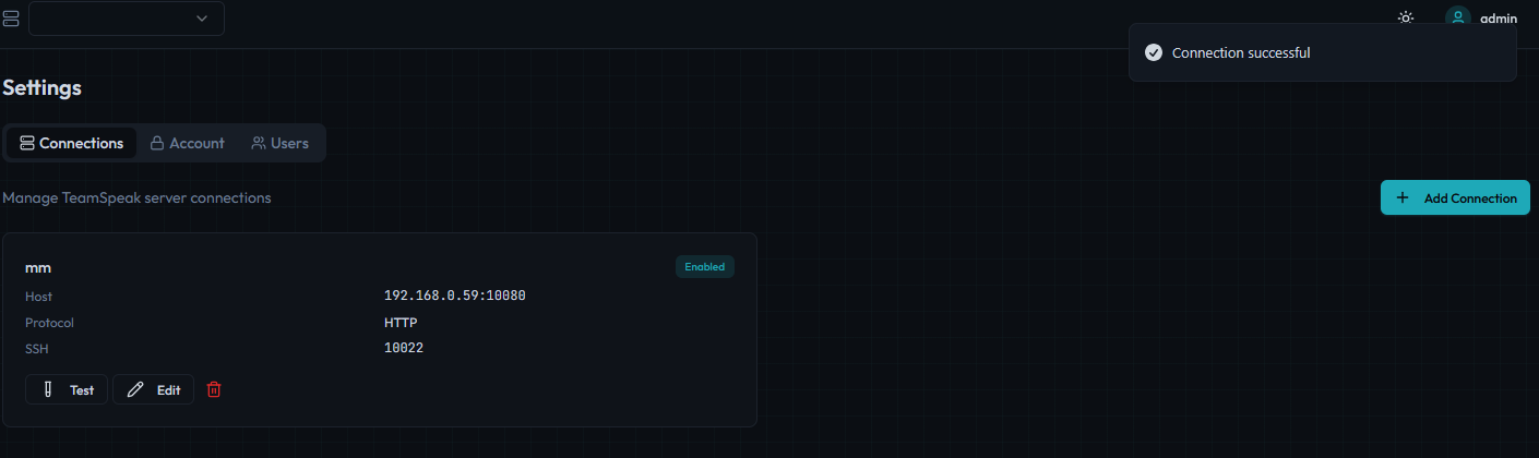

Fist i have the same issue. Connection was there, but no Server show up.
Here is my setup:
add this to my Teamspeak docker file
    ports:
      - "10443:10443/tcp" # WebQuery port HTTPS
      - "10022:10022/tcp" # SSHQuery port
    environment:
      # - TSSERVER_QUERY_HTTP_ENABLED=true
      # - TSSERVER_QUERY_HTTP_PORT=10011
      - TSSERVER_QUERY_HTTPS_ENABLED=true
      - TSSERVER_QUERY_HTTPS_CERT=/certs/cert.pem
      - TSSERVER_QUERY_HTTPS_PRIVATE_KEY=/certs/key.pem
      - TSSERVER_QUERY_SSH_ENABLED=true
    volumes:
      - /opt/ts6server/cert.pem:/certs/cert.pem
      - /opt/ts6server/key.pem:/certs/key.pem
Create the Certs in the right folder and chmod 644
openssl req -x509 -newkey rsa:4096 -keyout key.pem -out cert.pem -days 3650 -nodes -subj “/CN=ADD YOUR IP/FQDN”
add this to the TS6 Manager docker file:
environment:
  - NODE_TLS_REJECT_UNAUTHORIZED=0
I think this was all, i hope i forgot nothing …

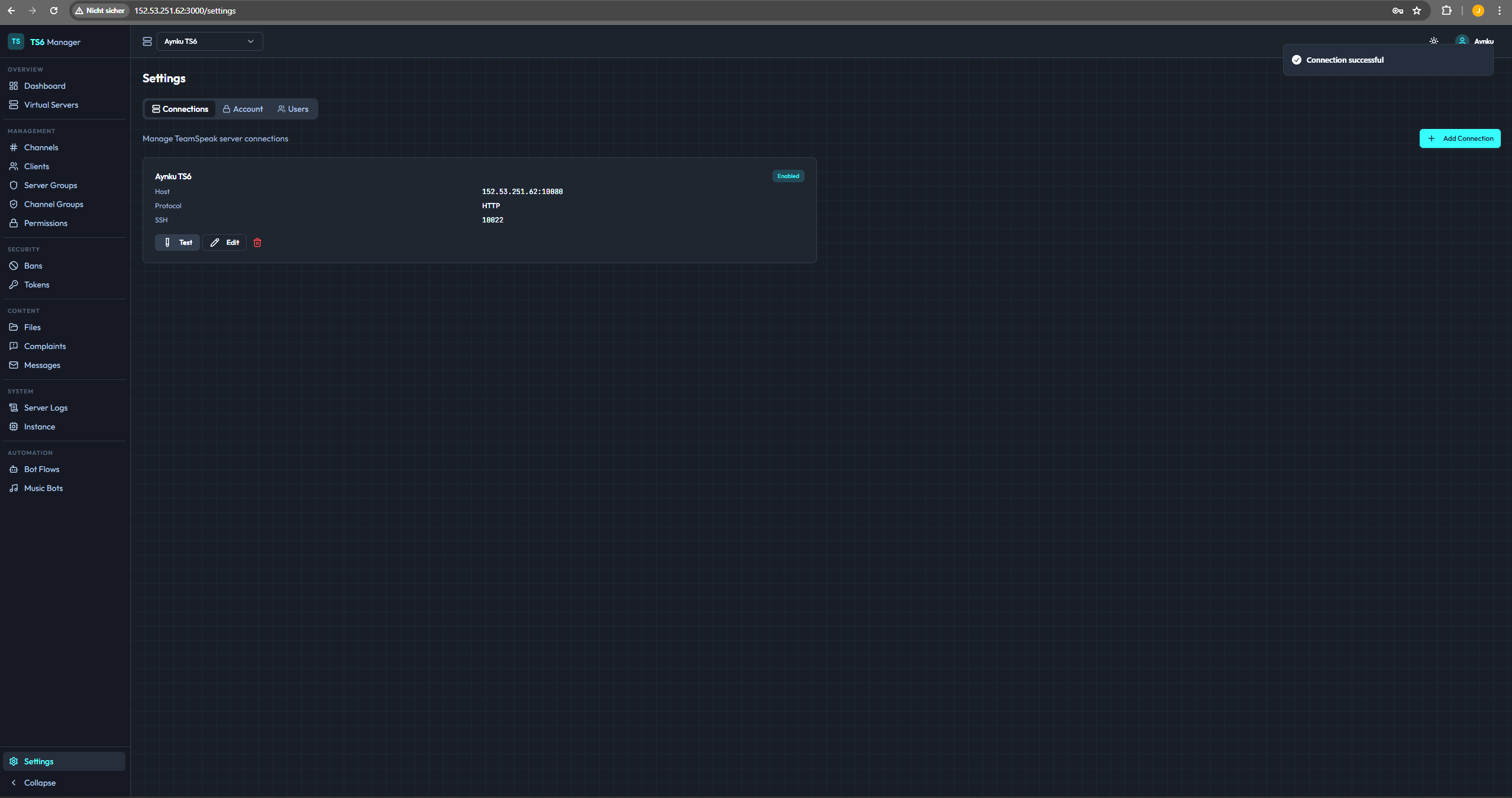

Did you unlock the IP in the query_ip_allowlist.txt ?
Yes i’ve done this
I’ve tried everything, such as WebQuery HTTPS with self-signed certificates, and still nothing.
I’m so lost that I don’t even know what’s happening right now xD
I think I’m going to have to abandon this project for now, I’m having problems and I can’t solve them.
All you guys that have errors connecting.
Can you provide logs? - just go in the Directory of the docker-compose.yml and hit docker compose logs -f
Maybe refresh the Manager dasboard to See the error message that comes up.
as @GingerFury_Phil mean, i find my solutions in the logs:
