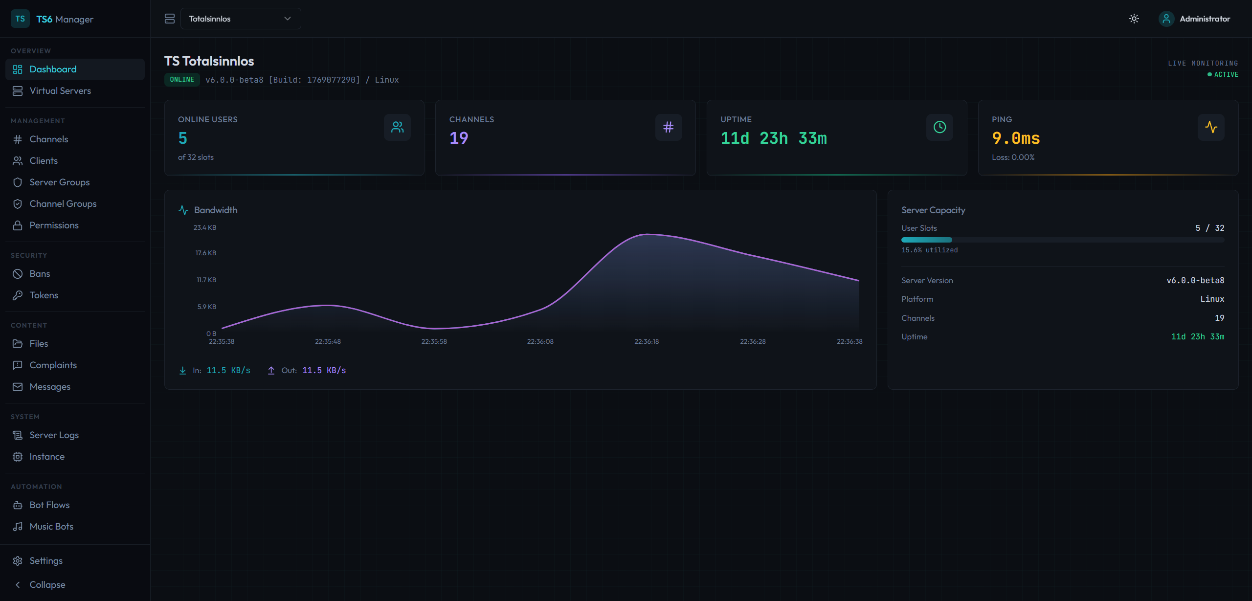

  • Live dashboard with online users, channels, uptime, bandwidth graphs
  • Channel tree, client list with kick/ban/move/poke

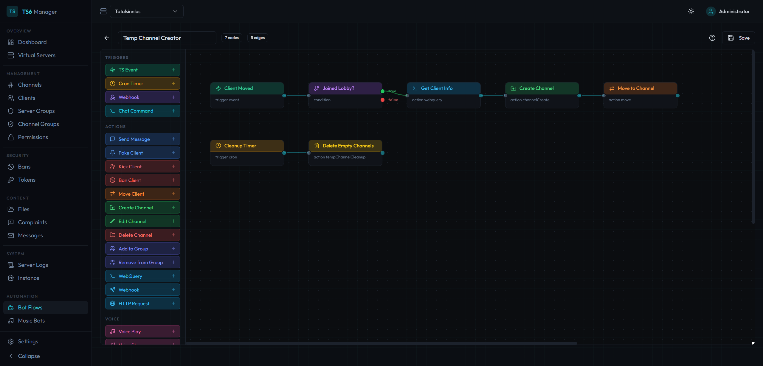

Bot Flow Engine
A visual drag-and-drop editor for building server automations. Connect trigger nodes to action nodes and deploy flows without writing code.
Triggers: TS3 events (client join/leave/move, text messages), cron schedules, webhooks, chat commands
Actions: Kick, ban, move, message, poke, create/edit/delete channels, and more
Logic: Conditions, variables, delays, loops, expressions with placeholders
Use cases: AFK movers, idle kickers, welcome messages, temporary channel creation, online counters, animated channel names, group protection, …

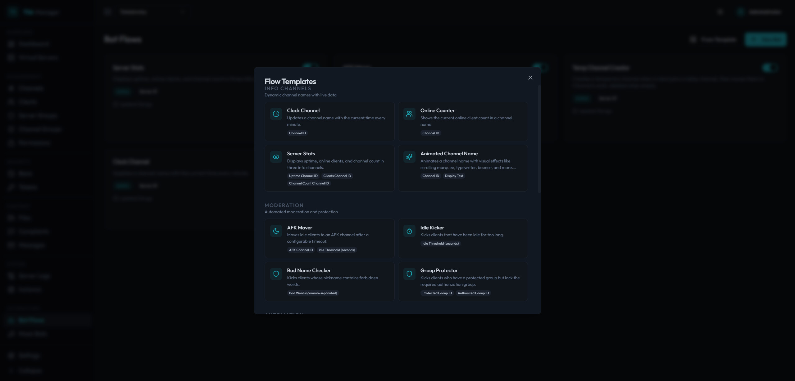

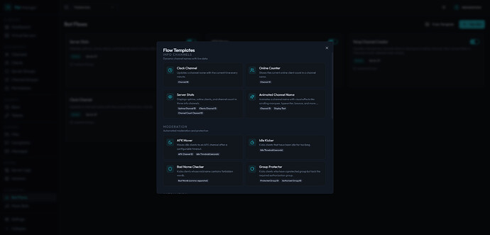

Comes with pre-built templates so you don’t have to start from scratch.

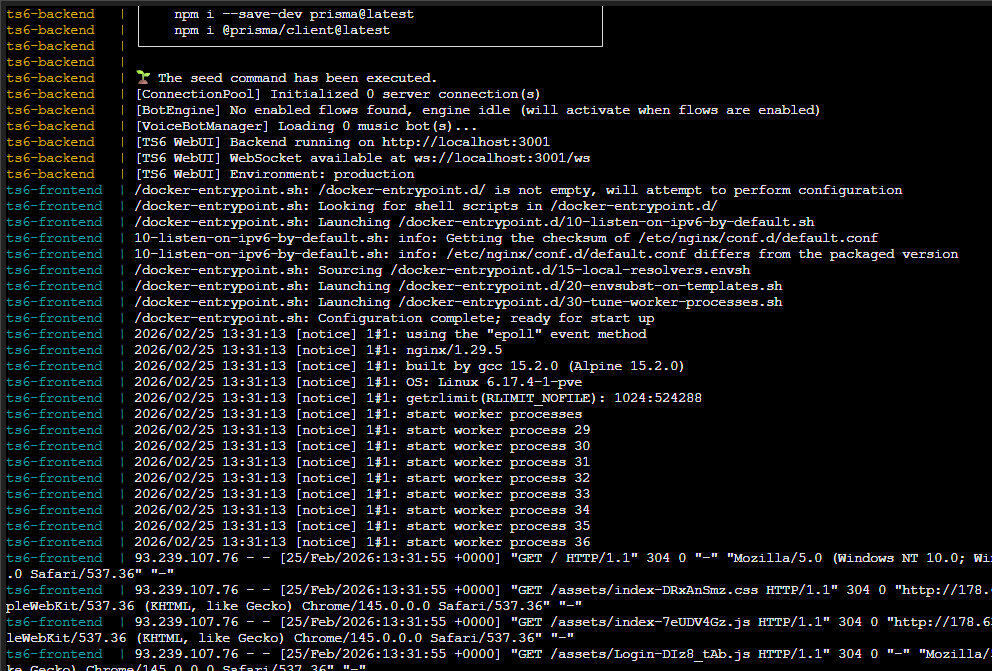

I set it up just like it was written in your docs on Github. (docker-compose with your docker-compose.yml)
I set the JWT secret and startet the container just like it was written in the docs.
Its running fine so far no errors and i can reach the frontend directly from my browser (Backend API is also running)

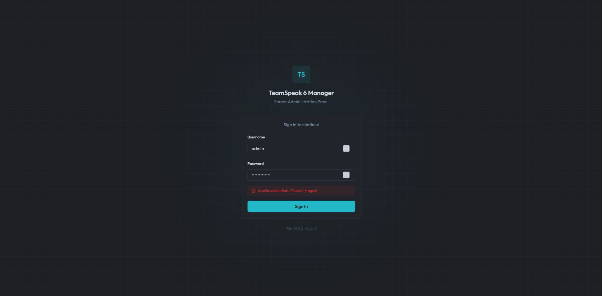

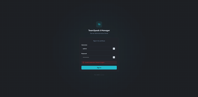

But now the Problem: the first admin account on the first startup.
In the docs it’s written, that i have to set it up on first launch.
But i only get the “normal” login screen when i launch the UI:
In the logs also no errors, so I guess I am doing something wrong here:
Also tested if it’s because I was not reaching from local (cause I try to host it on one of my VPS’s)
But also when i run it locally on my home computer and reach it via localhost:3000 i only get the “normal” login.
Ah damn it! Yeah sorry, the image is not up2date with the setup manager. You can use admin/admin as default creds.

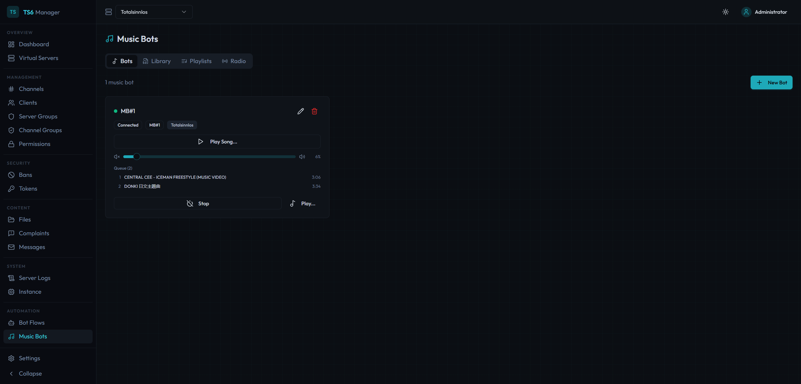

Was able to test something around. So far it works pretty good besides some minor things that come up. But at first the yt-dlp function for the music bot: I was not able to use it cause i am getting a constant error from the backend:
Error: yt-dlp info failed (code 1): WARNING: [youtube] No supported JavaScript runtime could be found. Only deno is enabled by default;
I double checked deno is installed in the backend container and on the VPS the container is running.
But it always comes with this error, is there maybe something else so set up?

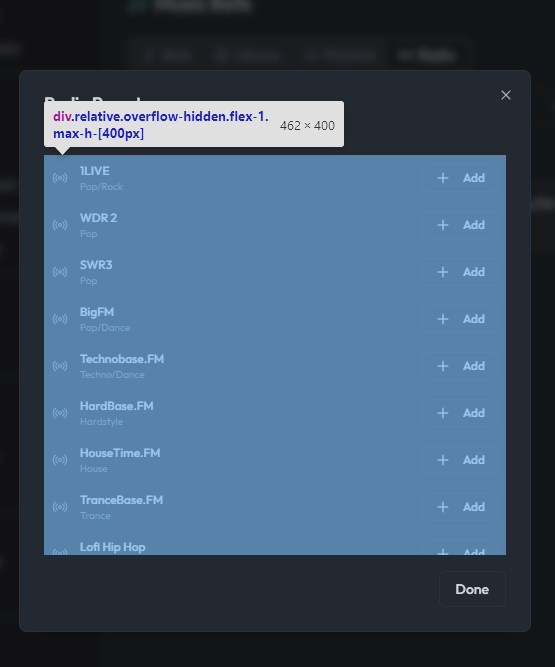

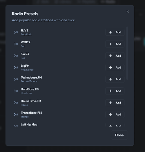

And a little CSS thing (before I’am forgetting it):
Because the div with hidden scroll is wrapped inside a div with overflow: hidden you cant scroll through the presets.
overflow: auto does the trick for me:

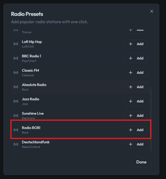

Have to mention real quick - Only good taste in music would make someone add RadioBOB to their presets. :wink:

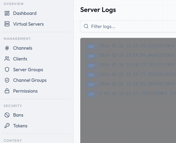

Light Mode CSS Colors
You may have just been mostly using dark mode when developing and testing this thing - which is understandable. I thought your dark mode was too dark, so i prefer light mode in this case :stuck_out_tongue:

Good find! Has to be fixed and will be fixed soon.
