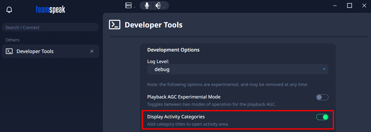

  1. Chats.
What you’re describing here is the “Activity Area”. You can think of it like browser tabs. Whether you’re connected to a server, receive a message, get poked, open a chat, etc., everything shows up there for easy access and an overview of your activities in the client. You can also pin Contacts or Chats by double-clicking them.
You can also enable/disable the Chat History by going to Settings > Chats > and then under Options > Use Chat History, which allows you to view your chat history in a separate tab.
To avoid confusion between categories (In the Activity Area), please make sure that “Display Activity Categories” is enabled under “Developer Tools”:
