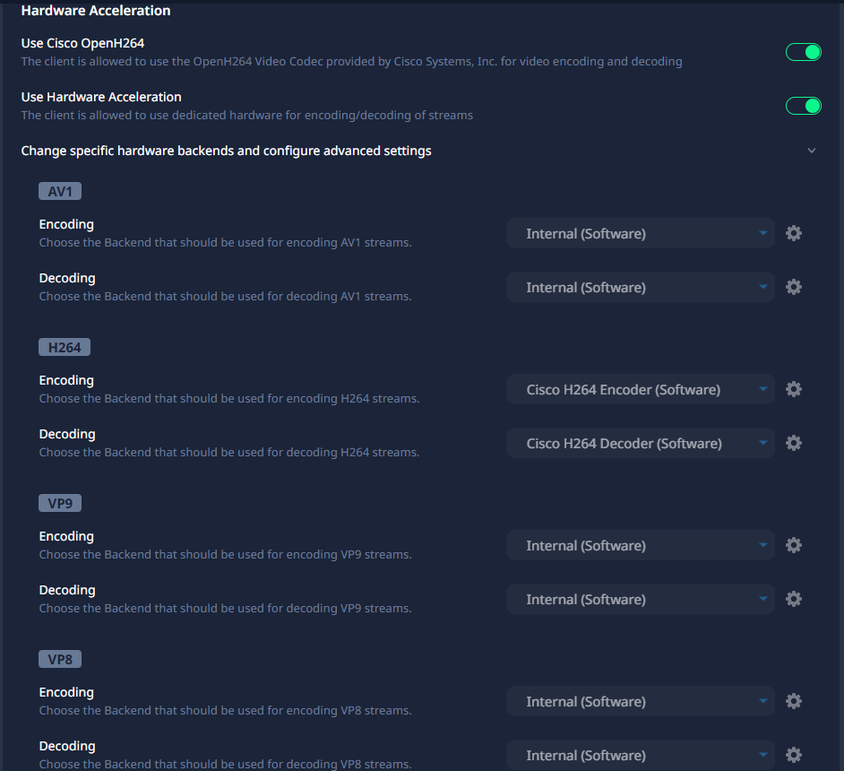

Unable to change codecs for screen sharing // Hardware Acceleration is not available on specific hardware configurations
In Settings > Video:
I don’t have the ability to change any of the settings below the 2 switches (• Use Cisco H264 and • Use Hardware Acceleration). I can switch both of the switches on or off, but all the other options are grayed-out. Clicking anywhere has no affect.
Any ideas, guys? Thanks in advance for any help.
Edit: Windows 11 Home

After a little research, it looks like the hardware is too old or not in the current implementation.
Your CPU supports Intel Quicksync, but only version 1.0, and this has probably not been taken into account in the current hardware acceleration implementation of TeamSpeak.
Your GPU does not yet support NVIDIA NVENC.
That’s why everything is greyed out for you and only the software encoder/decoder is used.

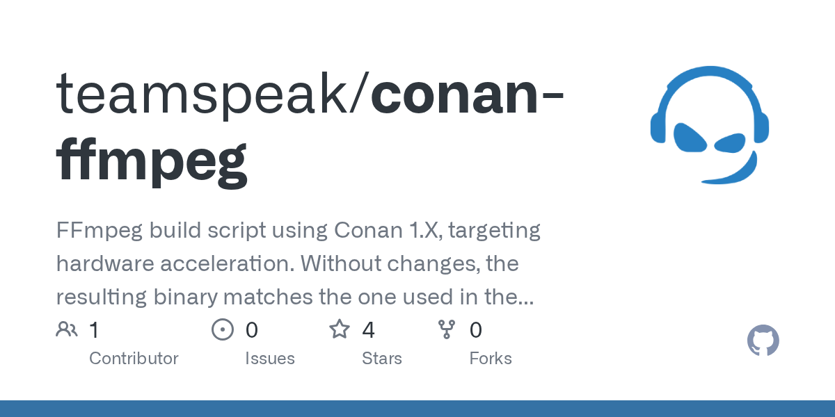

Question. In the changelog it says that we can use “our own” FFmpeg if we want. How do we do that? I guessing by simply replacing the ffmpeg.exe file in a specific folder…?
Have a look on the teamspeak github here:
Thanks. I read the whole thing (github link you provided) and saw this towards the end:
”…To use in the TeamSpeak 6 Client, copy the contents of package/.../lib/ (and package/.../bin/ on Win) to your TeamSpeak installation path. Backup existing libraries if anything goes wrong.”
Ok, but exactly where do I paste it in the Teamspeak 6 Client installation directory? Can you give me the default path ffmpeg.exe needs to live? Where is it on your system?
C:\Program Files\TeamSpeak\<and then?>
You absolutely do not need to compile your own ffmpeg. TeamSpeak ships with a version that should work out of the box. And I case it doesn’t it’s more likely a driver issue than an installation problem.

Quite a few issues….
Based on the logs the system does not meet our current requirements for hardware acceleration, therefore defaulting back to the software encoder / decoder.
However I’ll forward this topic to our QA / dev team to further investigate this and if HWA is possible on such old system.
Thanks, LeonMarcelHD
and to everyone else for replying to my post.
So, if I am understanding your reply correctly, in my case, Teamspeak will revert back to software encoding (CPU) by default, right? If so, which codec will it be using for screensharing, the Cisco H264 Encoder?
Thanks everyone!
If I am not mistaken yes, but only running on your CPU, rather than your GPU.
