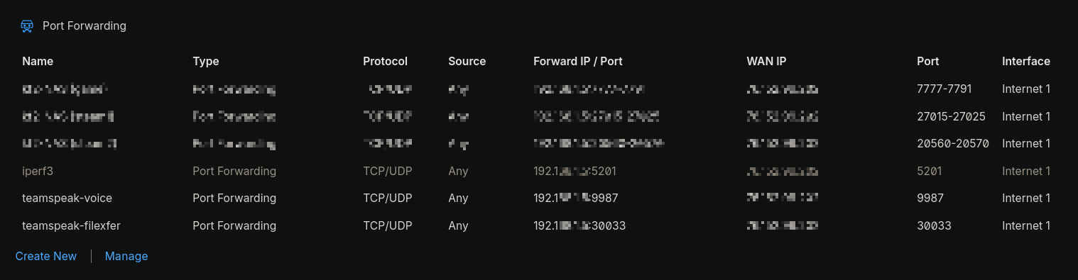

I’ve been running my TS3 server for over 10 years now without problems. Just recently I decided to retire my Cisco router and go to a Unifi Dream Machine Pro SE unit. (also know as UDM SE by the fan boys).
Problem: It blocks access to my TeamSpeak 3 server. This happens both internally and externally.
I know the first FAQ you might ask if I got all the port mapping settings done. I’ve double checked and cannot find any problems there.
Also, I can attempt to reach the server directly via it’s local VLAN IP address with both machines on the same switch and the UDM still blocks connection.
The only way I can restore connection is to return to my old Cisco router and reset the Unifi Pro Max switch. Afterwords all works fine.
Some feedback on the Unifi’s website remarks that the UDM’s security blocking features are most likely at fault. Knowing this I turned as much stuff off that the user UI would allow with still no results.
Any one else have experience with this and a solution?
Thanks in advance!!

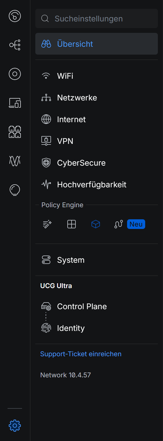

Go to the UDM management panel → Settings (sidebar, bottom left) → Sites Manager → your site → Settings → Network → Port Forwarding.
if u got a newer version like this check Settings → Policy Engine
Thank you for the reply. Yes, I have the 3 above mentioned ports mapped to the local LAN IP for my server (just like the Cisco router I want to replace that works fine). I also checked that UPnP was disabled as the Unifi support team suggested that might be an issue if enabled.
So far, no luck. It’s as if some hidden firewall filter of policy is sniffing out something it doesn’t like and blocking my TS server within a minute of connection (It will work internally for a minute before kicking my client).
I’ve also played with disabling what limited end-user options are in the content filtering section but again no luck.
I have a ticket pending with Unifi that has been escalated, which means I might be waiting for awhile……..
