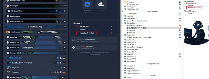

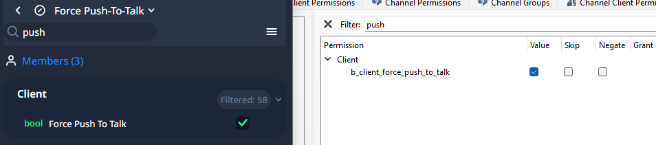

I noticed that the b_client_force_push_to_talk permission is not working correctly in TeamSpeak 6 v6.0.0-beta4.1. The permission is enabled through the Force Push-To-Talk server group and should prevent the affected client from transmitting by Voice Activation.
For comparison, I connected to the same server with both the TeamSpeak 6 client and the TeamSpeak 3 client. Both clients are assigned to the same server group containing the b_client_force_push_to_talk permission
and Voice Activation is configured on both clients.
As shown in the attached screenshot, the TeamSpeak 6 client can transmit using Voice Activation despite having the Force Push-To-Talk server group. The TeamSpeak 3 client, however, correctly applies the permission and does not allow transmission without pressing the configured Push-to-Talk key.
The permission and server group are configured correctly, as everything works as expected in TeamSpeak 3. It seems that TeamSpeak 6 simply does not apply the b_client_force_push_to_talk permission.
